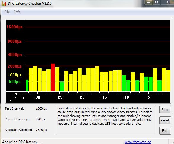

HSCIII Posted May 10, 2012 Posted May 10, 2012 Fuirst thank you so much for helping me.I made all the update as you suggested. I haven't had a chance to push the compute using Sonar Xl1, however, I have yet to expereiance any drops when just playing audio,wheter its itunes of a different file format in a different player.Prior to the updates the drop outs where coming fairly often as of the last 2 weeks.However after running for 4-5 minutes the Latency monitor applciation states i have issues will likely cause drop outs,clicks etc. ( see below)I have stopped using my powered USB port excpr when its explcitily needed but it looks like USB is still a source of issues. In device manager there looked to be way too many instances of generic USB Root Hub, but I'm not sure what action to takeI'll run the test to create another trace file so should you request it,I'll it hready to sendthanks againCONCLUSION_________________________________________________________________________________________________________Your system appears to be having trouble handling real-time audio and other tasks. You are likely to experience buffer underruns appearing as drop outs, clicks or pops. One or more DPC routines belonging to a driver running in your system appear to be executing for too long. LatencyMon has been analyzing your system for 0:04:37 (h:mm:ss)_________________________________________________________________________________________________________System Information_________________________________________________________________________________________________________Computer name: HSC-PCOS version: Windows 7 , 6.1, build: 7600CPU: GenuineIntel Intel® Core2 Quad CPU Q8300 @ 2.50GHzLogical processors: 4RAM: 8553422848 totalVM: 2147352576, free: 1960853504_________________________________________________________________________________________________________CPU SPEED_________________________________________________________________________________________________________Reported CPU speed: 2493 MHzMeasured CPU speed: 1619 MHzNote: reported execution times may be calculated based on a fixed reported CPU speed. Disable variable speed settings like Intel Speed Step and AMD Cool N Quiet in the BIOS setup for more accurate results._________________________________________________________________________________________________________MEASURED KERNEL TIMER LATENCIES_________________________________________________________________________________________________________Highest measured kernel timer latency (µs): 2365.1805_________________________________________________________________________________________________________MEASURED SMIs AND CPU STALLS_________________________________________________________________________________________________________Highest measured SMI routine or CPU stall (µs) 16.4248_________________________________________________________________________________________________________REPORTED DPCs_________________________________________________________________________________________________________Highest DPC routine execution time (µs): 2567.3734Driver with highest DPC routine execution time: ataport.SYS - ATAPI Driver Extension, Microsoft CorporationHighest reported total DPC routine time (%): 3.7579Driver with highest DPC total execution time: USBPORT.SYS - USB 1.1 & 2.0 Port Driver, Microsoft CorporationTotal time spent in DPCs (%) 4.7465DPC count (execution time <250 µs): 1955890DPC count (execution time 250-500 µs): 0DPC count (execution time 500-999 µs): 604DPC count (execution time 1000-1999 µs): 3DPC count (execution time 2000-3999 µs): 1DPC count (execution time >=4000 µs): 0_________________________________________________________________________________________________________ REPORTED ISRs_________________________________________________________________________________________________________Highest ISR routine execution time (µs): 26.7990Driver with highest ISR routine execution time: ataport.SYS - ATAPI Driver Extension, Microsoft CorporationHighest reported total ISR routine time (%): 0.8630Driver with highest ISR total time: USBPORT.SYS - USB 1.1 & 2.0 Port Driver, Microsoft CorporationTotal time spent in ISRs (%) 0.1416ISR count (execution time <250 µs): 528311ISR count (execution time 250-500 µs): 0ISR count (execution time 500-999 µs): 0ISR count (execution time 1000-1999 µs): 0ISR count (execution time 2000-3999 µs): 0ISR count (execution time >=4000 µs): 0_________________________________________________________________________________________________________ REPORTED HARD PAGEFAULTS_________________________________________________________________________________________________________Process with highest pagefault count: noneTotal number of hard pagefaults 1184Hard pagefault count of hardest hit process: 355Highest hard pagefault resolution time (µs): 232783.1768Total time spent in hard pagefaults (%): 1.1357TODO: Number of processes hit: 0_________________________________________________________________________________________________________ PER CPU DATA_________________________________________________________________________________________________________CPU 0 ISR count: 339904CPU 0 ISR highest execution time: 26.8580CPU 0 ISR total execution time: 609777.5146CPU 0 DPC count: 1142361CPU 0 DPC highest execution time: 2567.3734CPU 0 DPC total execution time: 18274091.1696_________________________________________________________________________________________________________CPU 1 ISR count: 62810CPU 1 ISR highest execution time: 24.4610CPU 1 ISR total execution time: 309104.7380CPU 1 DPC count: 273525CPU 1 DPC highest execution time: 420.9085CPU 1 DPC total execution time: 11420937.2394_________________________________________________________________________________________________________CPU 2 ISR count: 62572CPU 2 ISR highest execution time: 26.7990CPU 2 ISR total execution time: 335129.3072CPU 2 DPC count: 268384CPU 2 DPC highest execution time: 1321.9073CPU 2 DPC total execution time: 11702237.5600_________________________________________________________________________________________________________CPU 3 ISR count: 63025CPU 3 ISR highest execution time: 22.9089CPU 3 ISR total execution time: 318912.4973CPU 3 DPC count: 272228CPU 3 DPC highest execution time: 1227.1873CPU 3 DPC total execution time: 11299994.1945_________________________________________________________________________________________________________

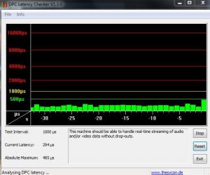

kenth Posted May 12, 2012 Posted May 12, 2012 Hello,I have an 2 units of Acer Veriton S670.They both have this problem of high CPU usage (60 to 80 percent) while idle.It is due to hardware interrupts, but the DPC Latency tool doesn't show any spike (high red bars). It just remains in the low green area. (Hope I'm making sense).How should I proceed from here?More info:unit 1 is running on WinXP SP3, I have run windows update and selected all the critical updates. I also have installed all the latest drivers.unit 2 is running on Win 7. At first this had the same problem, but it went away after I installed all the recent drivers. Both units have ATI Radeon 4350.
