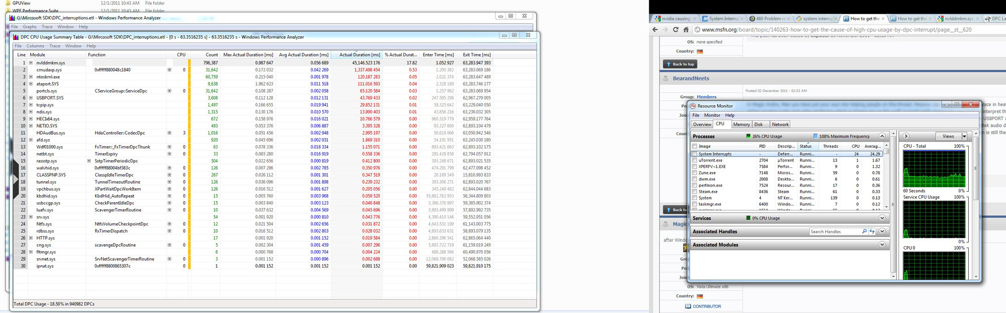

h3x00r Posted December 20, 2011 Posted December 20, 2011 (edited) When I use BitTorrent to download stuff I do have this an intrerruption problem causing high cpu usage (see the attachement)The ntoskrnl.exe seems to have some high values.In Process Explorer I do see a 5-6% CPU usage for Intrerrupts.I do have a Intel i7 @ 2.0Ghz and 12gig of ram.What happens? My mouse starts to slug.Thank You! Edited December 20, 2011 by h3x00r
MagicAndre1981 Posted December 20, 2011 Author Posted December 20, 2011 can you make a trace, compress it as 7z (LZMA2, Ultra) and upload it?

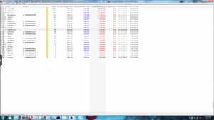

dougr Posted January 17, 2012 Posted January 17, 2012 Is it normal to get a bunch of results in these tests? On my DPC CPU Usage Summary Table ataport.SYS is what came up with the most usage but I really don't know how to go about fixing that one. On the other table: Interrupt CPU Usage Summary Table, hal.dll came up as the highest actual duration. Do any of my results really need to be fixed?
MagicAndre1981 Posted January 17, 2012 Author Posted January 17, 2012 Do you run a device (CD,DVD, HDD) in IDE/ATAPI mode?

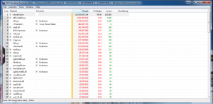

Damascus Posted January 18, 2012 Posted January 18, 2012 (edited) Hello Andre!I actually arrived to this thread after googling why NT Kernel & System was having CPU usage spikes on my new computer (~25% every minute or so, constantly). I just got this Dell laptop a few days ago and CPU usage issues started happening yesterday. I did update several drivers, including those of the graphics cards and the BIOS from the Dell site.I did everything you recommended on your post and I can't figure out what the results mean, could you help me out? I can't relate the results to a specific driver.I'm attaching a screenshot of the Sampling Summary Table showing the culprit (ntoskrnl.exe).If it helps I should tell you this:- The CPU usage spikes won't happen on safe mode.- A few days ago I shut down my computer and it started installing Windows Update files, I was in a hurry so I physically shut it down, next time when I tried to log in it crashed before the Windows start screen. I restarted it and it went fine.Could it be that I have a corrupted ntoskrnl.exe? Edited January 18, 2012 by Damascus
MagicAndre1981 Posted January 18, 2012 Author Posted January 18, 2012 can you also compress the ETL file and upload it?
