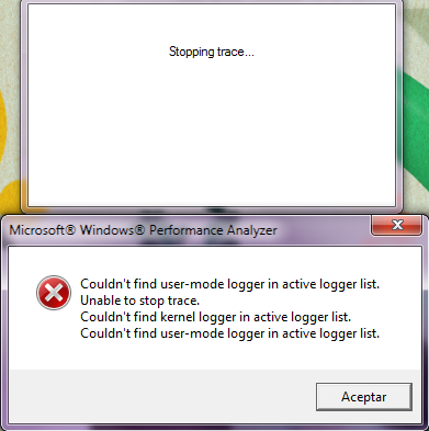

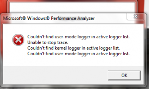

SonofNun Posted October 16, 2011 Posted October 16, 2011 can you give me the latest trace so tjhat I can look at it?For some reason, I am getting the following error:
MagicAndre1981 Posted October 16, 2011 Author Posted October 16, 2011 I posted this to Allan, too:http://social.msdn.microsoft.com/Forums/en/wptk_v4/thread/b88aa183-d3ee-4cd1-92d6-e466c07e1a2fCheck this topic and make the registry changes.
SonofNun Posted October 16, 2011 Posted October 16, 2011 I tried changing the registry values to this:[HKEY_LOCAL_MACHINE\SOFTWARE\Microsoft\Dfrg\BootOptimizeFunction]"OptimizeComplete"="Y""OptimizeError"="""LcnStartLocation"="0""LcnEndLocation"="0""Enable"="Y"But it still doesn't work.Am I doing something wrong?
AllanFreelancer Posted October 16, 2011 Posted October 16, 2011 Remove the WPT 4.6 and install version 4.8 from the Windows SDK for Windows 7 ad .Net Framework 4.0 and try it again.Hi again MagicAndre,Same error again MagicAndre, as same as SnofNun, I don't get it, why this error appears after a boot optimizationmaybe a bug??? and I have the same values as in your post is.kind regards,Allan
SonofNun Posted October 16, 2011 Posted October 16, 2011 And the wierd thing is, it worked for me so many times.
