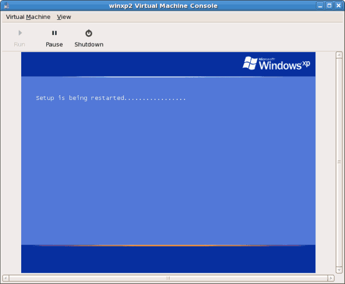

Schicklgruber Posted December 1, 2009 Author Posted December 1, 2009 Okay guys, I've got a sort-of new problem. So today I tried creating my ISO file over again. But this time, I integrated SP3 and IE7, and had no Unattended settings (no extra themes). I also enabled the uxtheme patch. I've attached my session.ini file if you guys want to look at it. This time, I had a different problem. So I booted into the ISO image with VirtualBox, and everything loaded fine. I formated, and it started copying setup files. But this time, I got an error message saying "Cannot copy clock.avi. Would you like to skip this file?" I skipped the clock.avi file. However, when it was finished copying setup files, it rebooted, showed the windows boot screen, and then it showed a screen that said "Setup is restarting..." and then kept restarting over and over again. I've attached a picture I got from Google images showing the screen that I am getting. Let me know if you need anymore information,-SchicklgruberLast_Session.ini
johnhc Posted December 1, 2009 Posted December 1, 2009 Schicklgruber, again I see nothing in your Last Session that concerns me. Have you done the things I have asked - install original CD in VB - checked size and MD5 of IE7? You definitely do not need the Uxtheme option. I also don't think it could have been a problem so early in Setup and I hope it would not cause Setup to fail - perhaps just not allow a theme. If you will look in the Last Session [Remove Files] section, you will see that avi.clock is listed - correct this error by removing this entry. Are you always starting with a fresh, fresh copy of you CD files/folders? Are you using nLite to create your ISO? The only thing left after the things I have suggested (assuming all OK) is the Tweaks, Drop all of them and see what happens. Please let us hear. Enjoy, John.
