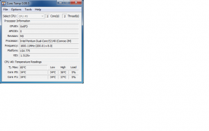

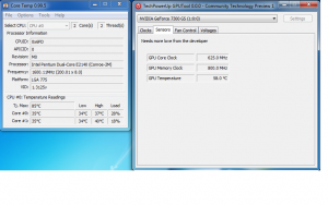

Junior2613 Posted November 8, 2009 Author Posted November 8, 2009 What I meant was im replacing it. I mean its a 250W GENERIC PSU not a lot of power coming from it and that COULD result in poor performance ? Only thing new is maybe a Google Sketchup update and a HD defrag. The HD activity light only really comes on like once in a while when the game needs to access some files, in windows it occasionally blinks once in a while. A snapshot of coretemps and Gpu tools, my cpu temps really max out at 45 during any game, and gpu goes anywhere between 60 - 85.Come to mention it I did run windows update last night it installed 4 updates for windows and 2 for IE8 it also wanted to download 1 for WDDM drivers for nVidia but I rejected because I have the latest drivers
Sl@y3D for my n@me Posted November 8, 2009 Posted November 8, 2009 Whoa, that graphics card is a tad hot. My 9600GT gets nowhere near that hot, idle or playing games on the highest settings. I don't like the look of that.Just to make sure though, I'd recommend a system restore. Restore to before you had the FPS drop. If that doesn't fix it, my bet is on the graphics card.

Zenskas Posted November 9, 2009 Posted November 9, 2009 Whoa, that graphics card is a tad hot. My 9600GT gets nowhere near that hot, idle or playing games on the highest settings. I don't like the look of that.Just to make sure though, I'd recommend a system restore. Restore to before you had the FPS drop. If that doesn't fix it, my bet is on the graphics card.I'd say his 7300GS has a tiny fan or is fanless. So over 60C aint so bad. It could handle 85C but that is not very safe or good at all! My 9600GT only does under 60C at all times no matter what but would have a much larger HS and fan than any 7300GS!I reinstalled windows 7 and installed nvidia forceware 187.62 and it seems to be ok now :S I think it might have been a driver problem I was on 191.07 that I downloaded from windows updates. By the way can you reccomend the 9600GT as a good step up from my current hardware ?? or will i need to look a bit higher ?Any GPU drivers downloaded from MS ain't gonna be good! Always download from NVIDIA's site. The MS NVIDIA drivers are not meant for gaming if they are the crappy ones I'm thinking of.The 9600GT would thrash your 7300GS by a huge amount. It would be around ten times faster in pure shader power and also has 57.6GB/s of memory bandwidth versus the 7300's 6.48GB/s!
