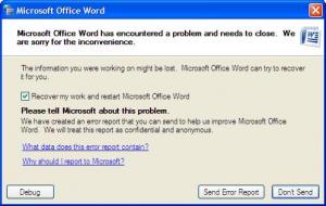

morland Posted May 14, 2009 Posted May 14, 2009 I recently switched from Office 2003 to Office 2007. Overall the new version is good but I am facing the following problem:95% of the times and when I close MS-Word 2007, the error messages shown in the attached images come up. Does any one have any clue as to why I am facing this problem and what could be the possible solution?Thanks
gamehead200 Posted May 14, 2009 Posted May 14, 2009 Do you have an HP printer? If so, is it set as your default printer? This is one reason why the error report prompt would pop up, but I have no idea what would cause the other error.
morland Posted May 14, 2009 Author Posted May 14, 2009 Yes I have a HP printer and it is the default one. I have just changed will monitor if that takes care of the problem. BTW this is strange that having an HP printer driver installed would result in Word-2007 crashing (assuming that is the reason).Many thanks for your reply.
gamehead200 Posted May 14, 2009 Posted May 14, 2009 Yes I have a HP printer and it is the default one. I have just changed will monitor if that takes care of the problem. BTW this is strange that having an HP printer driver installed would result in Word-2007 crashing (assuming that is the reason).Many thanks for your reply.I have the same problem, and so does a friend of mine. It's a known issue. Setting your default printer to, say, a PDF printer should fix it. It's an inconvenient workaround, but it does the job.
Anderton Posted May 14, 2009 Posted May 14, 2009 Last month (April), after one year (it takes ages to HP fixes this problem) HP finally begins to release a hotfix to this problem.This was the worst support case that I have ever seen in my life.After install all the new updates displayed in the HP page for my printer all my problems and errors with the Word 2007 are gone now. Even using HP as my default printer (no changing was necessary anymore).Good luck.
