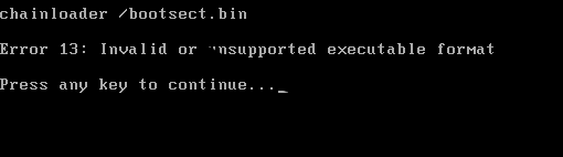

As you might have seen from my other posts, I am converting my CDShell over to Grub4Dos. I know it kind of figures, but I have a new issue I can not figure out.
I am trying to get my BartPE to run.
Here is the original command I had in my CDShell
chain /bootsect.bin
In Grub4Dos, I have tried using "chainloader /bootsect.bin", and it just comes up with the error in the screenshot.
What am I doing wrong, and how can I make just work?

What is "bootsect.bin"?
Is it a "CD no-emulation bootsector"? (A 2048 bytes file)?
Or is it a HD-like bootsector? (A 512 bytes file)?
IN BOTH CASES, you do not use bootsectors to load a BartPE. :whistle:
Grub4dos has some advantages over other bootloaders, as it can completely bypass ANY bootsector. :thumbup
You directly chainload the OS loader. :)
I.e. and this should have been clear enough on the Forums and docs I pointed you to, here are a couple examples:
title some flavour of BartPE
root (cd)
chainloader /I386/SETUPLDR.BIN
or
title some flavour of BartPE found
find --set-root /I386/SETUPLDR.BIN
Please take note that grub4dos is CaSe SeNsItIvE on CDFS filesystem!

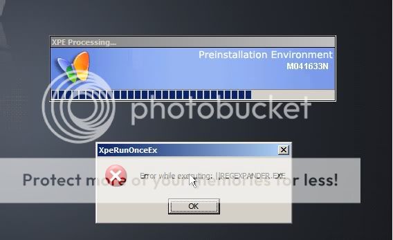

when i try to boot bartpe from grub4dos multiboot cd with these entries
title XPE
well it boots up but i get these errors
& finally i checked in the multiboot cd the file names are changed with 8 characters
can someone tell me how do i boot bartpe[xpe] without grub4dos's 8 character limit

There neither a 8 character limit at BartPE nor at grub4dos.
How do you build the ISO image?
Change your ISO creating tool settings to create long file names.

Ya! there's an 8 character limit in GRUB4DOS iso and
I tried grub4dos's bootable cd-rom method with mkisofs
mkisofs -R -b grldr -no-emul-boot -boot-load-size 4 -o grldr.iso iso_root
& i don't know how to create an iso with long file names. If i create an iso with long file names with these settings will it boot?
i've done it with diddy's grub4dos help file
Can someone tell me/help me in creating a grub4dos multiboot iso with long file name support (using MKISOFS same entry by modifying it to support long file names or some other help) :rolleyes:
Remember plain ISO9660 Level 1 allows 8.3 names only. Hence the current limitation.
You have to allow long names to get long names.
Bart himself use ISO-9660:1999 http://www.nu2.nu/pebuilder/#intro
Try
mkisofs -iso-level 4 -r -b grldr -no-emul-boot -boot-load-size 4 -o grldr.iso iso_root
File case is used from readed files at hard disk.
This assumes uppercase core boot file names at hard disk. PEBuilder uppercase reqiured files, if you build a ISO image.
Or use
mkisofs -iso-level 4 -force-uppercase -r -b grldr -no-emul-boot -boot-load-size 4 -o grldr.iso iso_root
All ISO9660 names are uppercased at CD.

I tried your code
but its the same problem [8character limit] still persist
Which files are limited to 8characters still?
Everything inside the iso :whistle::wacko:
"Mkisofs -iso-level 4 -r" allows names up to 193 chars. There is no way this result 8.3 names at DVD.
I doubt the new created ISO image is limited to 8.3 chars.
Did you create a new ISO image?

Hey i tried your code:
to create the iso & it boots correctly
This was my fault
I've created a dummy/empty iso with this code & then updated the grldr.iso with bartpe and all my bootables using ultraiso checked it in vm it gave me the same problem.
& then i changed the method like this
moved all my bootables including bartpe files to the iso_root directory & then created the iso & verified it in vm voila!! :thumbup it worked including all my bootables :thumbup i think updating the dummy/empty iso is my problem :whistle::D thank you verymuch cdob for sparing me your precious time in solving my problem :thumbup

My crystal ball lost another life. Yes, editing ISO images may truncate names.
Thanks for report.
