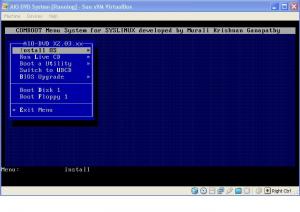

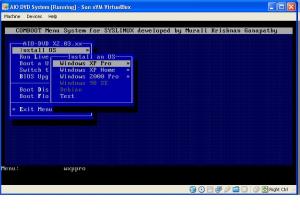

Why? I had a brief look at GRUB4DOS (after being slightly distracted by GNU GRUB!) and I don't see how it avoids bootsectors? It seems to chainload them so they'll still need to exist.
The current AIO can (for example) boot Windows 2000 SP4 for a regular install, boot Windows 2000 SP4 for an unattended install, boot Windows 2000 SP4 for an unattended install and silently install a "few" apps. It can do the same for Windows XP Pro SP3. That's six boot sectors and six boot folders.
I boot the DVD, start the boot menu, pick the OS, choose partitions and it does the rest, taking however long it takes.
Short of not offering so many options (and actually I offer more ...) I don't see how I can cut down on the number of boot sectors and associated boot folders. In fact, having recently integrated DriverPacks, I now find that the initial text mode boot slows down (by a number of minutes) so I want to make that an option too. (I still want DriverPacks so that if I install on an unfamiliar machine it installs as much as possible, but on my machines I want a slimmed down version so I'm not waiting so long).
That's part of the reason I started on this odyssey. If I put together a "build" tool that does what I want but takes out the bulk of the tedium, I can investigate speeding up the process while at the same time integrating the drivers I know I need (and perhaps decompressing them too).

I am not sure what you mean by "arrow driven text menu with radio buttons" :unsure:
Well I've just found that I don't know how to put a screen shot in here!
I've attached the images instead, maybe that'll actually work!
The DVD boots to an ISOLINUX splash screen (main.jpg).
I hit return to boot the DVD (rather than timing out and booting HD1) and then I get to the screen in install.jpg. I can now select menus with the usual left/right/up/down arrow mechanism until I get to apps.jpg. Here I've got what I want and I hit return. Now it will fire up XP and I'll end up (after manually partitioning) with Windows XP SP3 + updates + apps.
I don't have radio buttons yet, but if I did I'd compact thing somewhat and have a window with [sP0/SP1/SP2/SP3/SPextra] with exactly one selectable at a time and a separate radio button to choose DriverPacks or No DriverPacks. Just a small matter of programming.
-- deadbug
