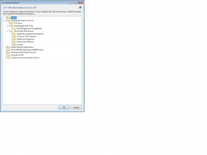

EDIT: Yeah, I've seen that link. The trouble is, my Control Panel makes no mention of .Net at all. It's not an installed program, nor is it a Windows Component. :/
Edited by Mr.Clark
You can find it in Programs and Features under "Turn Windows features on and off"
.NET framework.
.NET framework.
No I can't ;)

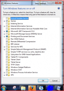

It was a bigger issue than just Office - once I reinstalled, I got the full Windows Components list that you posted.
