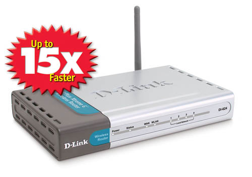

this Dlink with cable and wireless:

All these switches gives a lot of heat and maybe your friend have put them in a case with fans? :huh:
