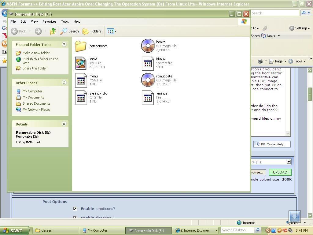

i installed the two tools from method two.. and used all the recommend options and now i got some wierd files on my flash drive so now what do i do.
ao now what do i do.. like i said i got the mem test iso which is like 1.756 KB's and i got the working windows xp iso on a disk already... so im waitin on the next step.. i noticed the site u gave me didnt give me the alternative setup instructions for the different methods.
There is a specific version of Memtest for USB but it requires DOS and you already have Syslinux setup on your USB. The way your stick is setup you could download the bootable Memtest binary and edit the syslinux file to boot it.....but I don't think we need bother. The point of the exercise was not to get Memtest working but to ensure you can boot from your USB prior to any further work. In retrospect I probably should've given you some more specific instructions. I was giving you advice from memory (quite a long time since I last did it) and was a little vague. If you are interested I can provide info to help you setup a USB with Memtest on it but lets get back to the issue here....
