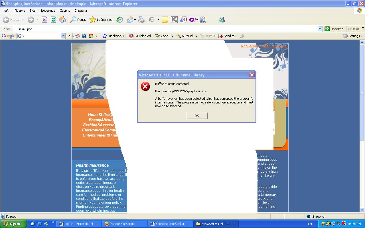

rickytheanuj Posted May 28, 2008 Posted May 28, 2008 I m using windows xp professional russian version. and from few days i m facing a explorer problem. (the screenshot is attached here). How can i solve this problem, and i m using kaspersky as antivirus.. and it detect that explorer.exe is transferring some hidden information... so it block it (explorer.exe) when i allow or deny it , it runs fine... but that message come in every minute... and allowing or denying that message several time my explorer.exe get terminated automatically....What's the matter.. please solve my problem.. Thank's in advance

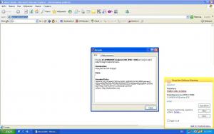

rickytheanuj Posted May 29, 2008 Author Posted May 29, 2008 I m using windows xp professional russian version. and from few days i m facing a explorer problem. (the screenshot is attached here). How can i solve this problem, and i m using kaspersky as antivirus.. and it detect that explorer.exe is transferring some hidden information... so it block it (explorer.exe) when i allow or deny it , it runs fine... but that message come in every minute... and allowing or denying that message several time my explorer.exe get terminated automatically....What's the matter.. please solve my problem.. Thank's in advanceWhen i allow or deny i faced this new problem , and when i click on ok the explorer get terminate automatically and i have to re-run the explorer.exe pressing alt+crt+del>new task...here is the picture of this..And one more thing I found that, when ever i click on any link in internet explorer then the above error appear and i have to allow or deny or quarintial explorer... how can i solve this problem.you guys said that the kaspersky is the main coz of this problem, but i don't want to uninstall kaspersky so please suggest me how can i set antivirus to allow that error always

Mr Snrub Posted May 29, 2008 Posted May 29, 2008 Based on the first screenshot, the destination IP address was 82.98.235.216...DNS info on the IP address:http://private.dnsstuff.com/tools/ipall.ch...n=82.98.235.216A quick search on that IP address brought up this:http://www.ca.com/securityadvisor/virusinf...s.aspx?id=69931Other references to Vundo/Virtumonde:http://vil.nai.com/vil/Content/v_127690.htmhttp://www.virtumonde.net/Given the referrer in the first image, and IE title bar in the second image implicate inetseeker.com, a search on "inetseeker vundo" brings up:http://www.spywareinfoforum.com/index.php?showtopic=99091The above references have detailed guides on how to go about removing the adware, if that's what you have.
