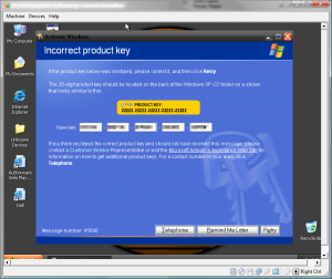

April 29, 200818 yr started with XP RTM (VLK) in straight 100% off the cd formintegrated SP3 with D:\SlipStreams>windowsxp-kb936929-sp3-x86-enu_c81472f7eeea2eca421e116cd4c03e2300ebfde4.exe -s d:\SlipStreams\WXP_SP0_PUREAction: added VLK to winnnt.sif[UserData]ProductKey=AAAAA-BBBBB-CCCCC-DDDDD-EEEEEResult: was asked for CD Key during install, VLK Key didnt work, pid.inf keys didAction: removed VLK key from winnt.sif added pid.inf keys to to winnnt.sif[UserData]ProductKey=CBY8F-CHBGQ-C6388-DTB2R-FFPRMResult: install progresses in full unattended like usual but oobe prompts for activation after booting (which was expected but id like to eliminate that too)the problem is oobe will not accept thee VLK key.Ok fine, Ill enter my VLK:Ideas?

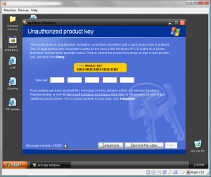

April 30, 200818 yr Author i just slipped it from inside the XP VM and right after i started it, i decided to take a screenshot because it looked too coolI had to remote to my work machine to do it so it looks extra confusingIts installing in the VM now so ill know if that worked soon
April 30, 200818 yr Author ok guys that must have been it. it took my VLK in the winnt.sif just like normal.i swear ive slipped SP2 on vista before without this problem so i must be a SP3 only type thing.
