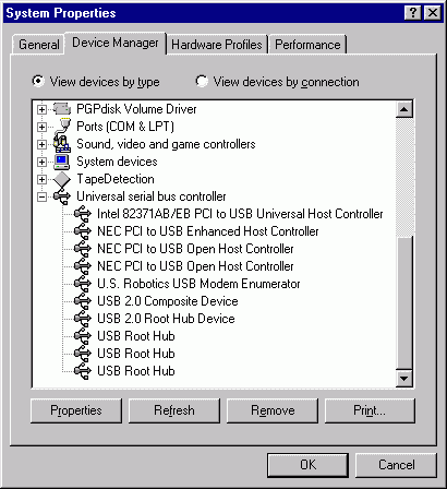

herbalist Posted February 9, 2008 Posted February 9, 2008 The USB that comes with 98FE does work. It's just slow when used with USB 2.0 compatible devices. My old HP had 2 USB ports which left me in the position of having to switch cables to use different devices. That became impossible when I added an external hard drive. The external hard drive worked on the factory USB ports but was very slow. The external hard drive was primarily for backups and data storage, so using USB 1.1 was not a major problem for me, just a slow annoyance. To make a long story short, not being able to use my other devices and the slowness of USB 1.1 convinced me to add a 5 port USB 2.0 card. The package said that 98SE was required but I installed it anyway and forced the install of the drivers. Turns out that USB 2.0 works just fine on 98FE, at least on my hardware. Many times faster than the factory USB ports. This was done before I learned of this site and the unofficial upgrades. Unless something I upgraded earlier made this work, I can only conclude that USB 2.0 can be made to work on 98FE.From my 98FE box:Regarding drivers, you may need specific ones for the USB devices you want to use. Most of the time, the vendor includes them with the device. I'm using a USB 56K Faxmodem, the WD external hard drive, a USB mouse, and a webcam. Except for the webcam and mouse, all of the USB devices including the USB card "required" 98SE or newer, according to the packages, CDs, read me files, etc. I had to extract the drivers for the WD hard drive and install them manually, but they all work properly on my 98FE box. Microsoft, software vendors, and hardware distributors alike exaggerate 98s obsolescense. Some just put it on the packaging or in the documentation. Others add the "incompatibility" to the installers, like Microsoft did with WMP-9 to keep it from installing on 98. One thing is clear. 98 first edition works well with more with newer hardware (and a lot of software) than the vendors tell you. The only way to know for sure is to try it, but if a piece of hardware says it needs at least 98SE (or WinME), there's a very good chance that it will work on 98FE as well. It really makes me wonder why they're trying so hard to steer users away from 98FE. Rick
