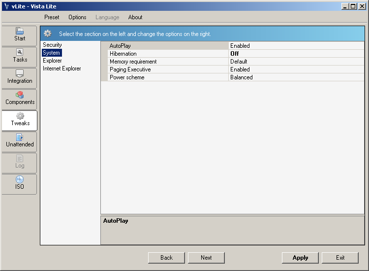

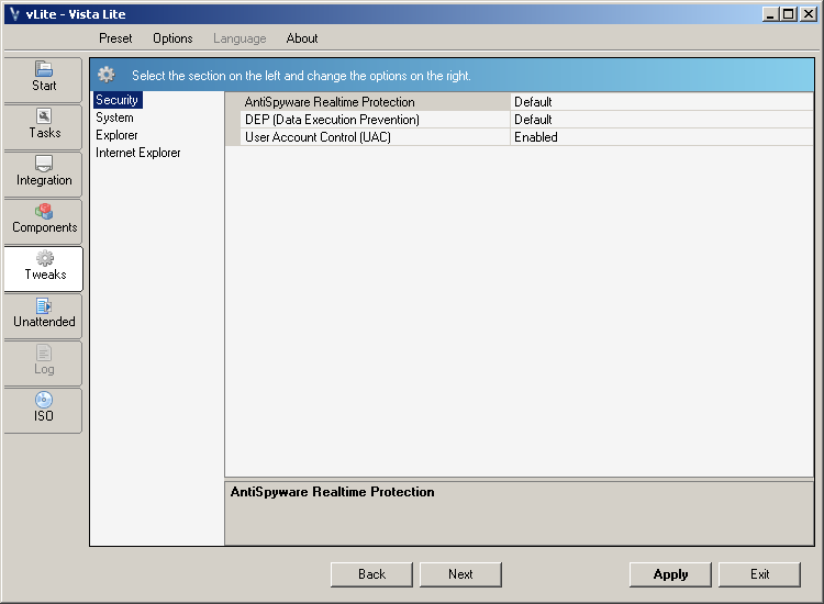

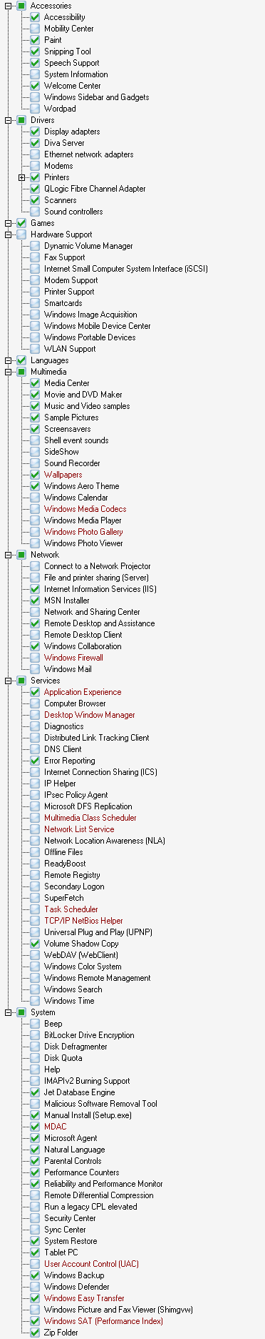

Just install this vLite (1.1 RC) Vista Ultimate, and the "search file" function (quick or advanced) do nothing.
If I type any characters in the top/right search field in Windows Explorer, nothing happen (no result, files are not filtered).
I guess, I checked (removed) a needed component for the Vista "search file" function.
Which one?
Previously, I had no problem using/testing vLite 1.1 Beta 2.
Where may I download vLite 1.1 Beta 2?
Thanks

I think that is "Natural Language" the culprit.
Edited by MFCK

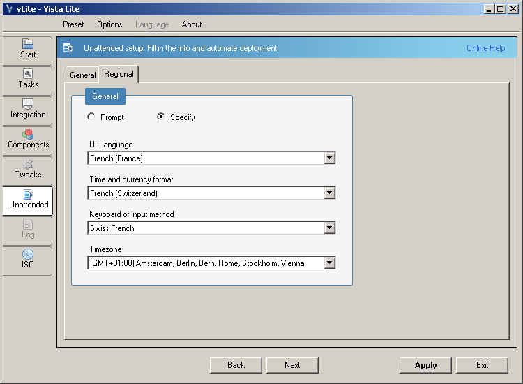

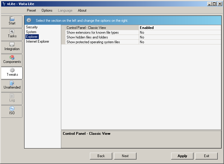

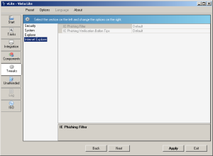

budhax, instead of all those screenshots you could have just attach the Last Session.ini file which has all the info inside it.
The component is Natural Language. Keep it, then download 1.0 and remove Natural Language if it has it.
Edited by nuhi
