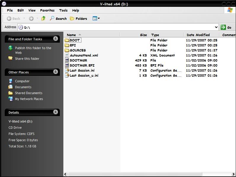

marauder16 Posted December 9, 2007 Posted December 9, 2007 (edited) I used the V-lite program (only left the ultimate x version, added some drivers and so on...), saved everything, burned all those files that were left on a DVD, tried to boot from it, but when it says 'Boot from CD:' it just does nothing and goes to HDD, like there was no DVD in the DVD-ROM...here are the contents of the DVD, maybe you can tell me what am I missing that's needed to boot from it:please help if you know what's wrong, thnx EDIT: didn't make an ISO out of it, think that's the problem, will burn a new one and see Edited December 9, 2007 by marauder16
nuhi Posted December 9, 2007 Posted December 9, 2007 It's the ISO creation issue when it rarely doesn't work for someone or the media was burned too fast.Use RW media so that you can test few times without any loss.Try MS tool, oscdimg to create ISO, then you can burn it with vLite.http://www.google.com/search?hl=en&as_...img&spell=1
marauder16 Posted December 9, 2007 Author Posted December 9, 2007 (edited) didn't even make an ISO last time (check my edit) sorry about that, but thnx for your replyEDIT: wow nuhi, sad sam tek skuzio da si iz HR, nisam znao da ima ljudi iz Hrvatske na ovom projetku, svaka cast na ovome i tebi i tvojim partnerima/suradnicima Edited December 9, 2007 by marauder16
nuhi Posted December 9, 2007 Posted December 9, 2007 If you used Direct Burn it's the same as making ISO and burning it, just more convenient. If you burned just files with Nero or something then it will not be bootable.Anyway if it's the first one then try that oscdimg.heh da to se cesto desi, ja sam ti jedini na ovom projektu, ako ne kontas ogromnu pomoc koju dobijem od svukud prilikom testiranja ili trazenja bugova.
marauder16 Posted December 10, 2007 Author Posted December 10, 2007 (edited) yeah, I used just nero, I'll make an iso and then burn it.thnx for your help jedini, pa lijepo, al pomoc je uvijek bitna, uglavnom, hvala na ovom programu puno pomaze, pozz Edited December 10, 2007 by marauder16
