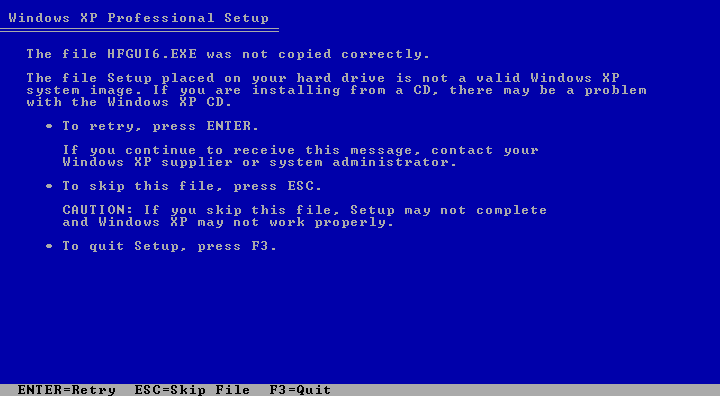

jimmsta Posted November 30, 2007 Posted November 30, 2007 I'm attaching my HFSLIP log file from the last build that exhibited problems in textmode setup, while copying files to the hard drive. Specifically, HFGUI4.EXE was not found while copying, yet installed fine at the GUIRUNONCE point in the installation. I've been getting these sorts of "missing" files since v1.7.0, and it's starting to get annoying. This file is automatically generated by HFSLIP HFSLIP is for personal use only Copyright(C) TommyP 2005-2007============================HOW TO REPORT A PROBLEM============================ If running into problems, refer to http://hfslip.org/support.html HFSLIP support forum: http://msfn.org/board/index.php?showforum=129===============================================================================HFSLIP Version - 1.7.1rc1 build 71127aHFSLIP Path - C:\XPHFS\OS in SOURCESS - XP SP2 EnglishMSIE Version - MSIE7Drivers - DRIVER.CAB UpdatedCD Install Path - DefaultCDTAG - WIN51INFO - Non-CAT files removed from SOURCE\I386\SVCPACK to avoid errors during Windows setup===============================================================================Files in your FIX folder:Files in your HF folder:directx_9c_redist.exeIE7-WindowsXP-KB938127-x86-ENU.exeIE7-WindowsXP-KB939653-x86-ENU.exeIE7-WindowsXP-x86-enu.exeNDP1.0sp3-KB930494-X86-Ocm-Enu.exeQ282784_WXP_SP1_x86_ENU.exerootsupd.exeWindowsInstaller-KB893803-v2-x86.exewindowsmedia11-kb928788-x86-intl.exewindowsmedia11-kb929399-v2-x86-intl.exewindowsmedia11-kb929773-x86-intl.exewindowsmedia11-kb932390-x86-intl.exewindowsmedia11-kb933547-x86-intl.exewindowsmedia11-kb935551-x86-intl.exewindowsmedia11-kb935552-x86-intl.exeWindowsMedia11-KB936782-x86-ENU.exewindowsmedia11-kb939209-x86-intl.exeWindowsMedia11-KB939683-x86-ENU.exewindowsmedia11-kb942264-x86-intl.exewindowsmedia11-kb944110-x86-intl.exeWindowsMedia6-KB925398-v2-x86-ENU.exeWindowsMedia-KB911564-x86-ENU.exeWindowsUpdateAgent30-x86.exeWindowsXP-KB835935-SP2-ENU.exeWindowsXP-KB873339-x86-ENU.exeWindowsXP-KB885836-x86-ENU.exeWindowsXP-KB886185-x86-enu.exeWindowsXP-KB887472-x86-enu.exeWindowsXP-KB888302-x86-ENU.exeWindowsXP-KB890859-x86-ENU.exeWindowsXP-KB891781-x86-ENU.exeWindowsXP-KB893756-x86-ENU.exeWindowsXP-KB896344-v2-x86-ENU.exeWindowsXP-KB896358-x86-ENU.exeWindowsXP-KB896423-x86-ENU.exeWindowsXP-KB896428-x86-ENU.exeWindowsXP-KB898461-x86-ENU.exeWindowsXP-KB898543-v3-x86-ENU.exeWindowsXP-KB899587-x86-ENU.exeWindowsXP-KB899591-x86-ENU.exeWindowsXP-KB900485-v2-x86-ENU.exeWindowsXP-KB900725-x86-ENU.exeWindowsXP-KB901017-x86-ENU.exeWindowsXP-KB901190-x86-ENU.exeWindowsXP-KB901214-x86-ENU.exeWindowsXP-KB904706-v2-x86-ENU.exeWindowsXP-KB905414-x86-ENU.exeWindowsXP-KB905749-x86-ENU.exeWindowsXP-KB907265-x86-ENU.exeWindowsXP-KB908519-x86-ENU.exeWindowsXP-KB908531-v2-x86-ENU.exeWindowsXP-KB910437-x86-ENU.exeWindowsXP-KB911280-v2-x86-ENU.exeWindowsXP-KB911562-x86-ENU.exeWindowsXP-KB911927-x86-ENU.exeWindowsXP-KB912817-v2-x86-ENU.exeWindowsXP-KB913580-x86-ENU.exeWindowsXP-KB914388-x86-ENU.exeWindowsXP-KB914389-x86-ENU.exeWindowsXP-KB914440-v12-x86-ENU.exeWindowsXP-KB916595-x86-ENU.exeWindowsXP-KB917537-x86-ENU.exeWindowsXP-KB917953-x86-ENU.exeWindowsXP-KB918118-x86-ENU.exeWindowsXP-KB918439-x86-ENU.exeWindowsXP-KB919007-x86-ENU.exeWindowsXP-KB920213-x86-ENU.exeWindowsXP-KB920342-x86-ENU.exeWindowsXP-KB920670-x86-ENU.exeWindowsXP-KB920683-x86-ENU.exeWindowsXP-KB920685-x86-ENU.exeWindowsXP-KB920872-x86-ENU.exeWindowsXP-KB921503-x86-ENU.exeWindowsXP-KB922582-x86-ENU.exeWindowsXP-KB922819-x86-ENU.exeWindowsXP-KB923191-x86-ENU.exeWindowsXP-KB923414-x86-ENU.exeWindowsXP-KB923789-x86-ENU.exeWindowsXP-KB923980-x86-ENU.exeWindowsXP-KB924270-x86-ENU.exeWindowsXP-KB924667-x86-ENU.exeWindowsXP-KB925876-x86-ENU.exeWindowsXP-KB925902-x86-ENU.exeWindowsXP-KB926247-x86-ENU.exeWindowsXP-KB926255-x86-ENU.exeWindowsXP-KB926436-x86-ENU.exeWindowsXP-KB927779-x86-ENU.exeWindowsXP-KB927802-x86-ENU.exeWindowsXP-KB927891-v3-x86-ENU.exeWindowsXP-KB928255-x86-ENU.exeWindowsXP-KB929123-x86-ENU.exeWindowsXP-KB930178-x86-ENU.exeWindowsXP-KB930916-x86-ENU.exeWindowsXP-KB931261-x86-ENU.exeWindowsXP-KB931784-x86-ENU.exeWindowsXP-KB932168-x86-ENU.exeWindowsXP-KB933729-x86-ENU.exeWindowsXP-KB935448-x86-ENU.exeWindowsXP-KB935839-x86-ENU.exeWindowsXP-KB935840-x86-ENU.exeWindowsXP-KB935843-x86-ENU.exeWindowsXP-KB936021-x86-ENU.exeWindowsXP-KB936357-v2-x86-ENU.exeWindowsXP-KB938828-x86-ENU.exeWindowsXP-KB938829-x86-ENU.exeWindowsXP-KB939373-x86-ENU.exeWindowsXP-KB941202-x86-ENU.exeWindowsXP-KB943460-x86-ENU.exeWindowsXPMediaCenter2005-KB900325-usa.exeWindowsXPMediaCenter2005-KB925766-ENU.exewmp11-windowsxp-x86-enu.exeFiles in your HFCABS folder:Apr2005_d3dx9_25_x86.cabApr2006_d3dx9_30_x86.cabApr2006_MDX1_x86.cabApr2006_MDX1_x86_Archive.cabApr2006_XACT_x86.cabApr2006_xinput_x86.cabAPR2007_d3dx10_33_x86.cabAPR2007_d3dx9_33_x86.cabAPR2007_XACT_x86.cabAPR2007_xinput_x86.cabAug2005_d3dx9_27_x86.cabAUG2006_XACT_x86.cabAUG2006_xinput_x86.cabAUG2007_d3dx10_35_x86.cabAUG2007_d3dx9_35_x86.cabAUG2007_XACT_x86.cabDec2005_d3dx9_28_x86.cabDEC2006_d3dx10_00_x86.cabDEC2006_d3dx9_32_x86.cabDEC2006_XACT_x86.cabFeb2005_d3dx9_24_x86.cabFeb2006_d3dx9_29_x86.cabFeb2006_XACT_x86.cabFEB2007_XACT_x86.cabJun2005_d3dx9_26_x86.cabJUN2006_XACT_x86.cabJUN2007_d3dx10_34_x86.cabJUN2007_d3dx9_34_x86.cabJUN2007_XACT_x86.cabLegitCheckControl.cabMUAuth.cabMuCatalogWebControl.cabMUWEB_SITE.CABNOV2007_d3dx10_36_x86.cabNOV2007_d3dx9_36_x86.cabNOV2007_X3DAudio_x86.cabNOV2007_XACT_x86.cabOct2005_xinput_x86.cabOCT2006_d3dx9_31_x86.cabOCT2006_XACT_x86.cabOGAControl.cabswflash.cabFiles in your HFSVCPACK folder:0NET11SP1.exe2NET20SP1.exe3VC05SP1.exe4NET35.exe6ORuntimes.exegeneral_custom.reggeneral_settings.reginternet_explorer.regmultimedia.regoutlook_express.regSP2_only.regsystem_performance.regFiles in your HFSVCPACK_SW1 folder:UPHClean-Setup.msiFiles in your HFSVCPACK_SW2 folder:Files in your HFGUIRUNONCE folder:4ISScript.exe5J2SE603.exe6AR811.exe7VCPACK.exeFiles in your HFTOOLS folder:7za.exebbie.exebbie.licBOOT.BINCABARC.EXECABINET.DLLcWnd.execygwin1.dllDrivercabHelper.au3DrivercabHelper.exeEXTRACT.EXEHFANSWER.INIHFSLIP_POST_getnewfiles_v3.cmdHFSLIP_PRE_TZ3.CABHFSLIP_PRE_TZ3.CMDMAKECAB.EXEmkisofs.exemodifyPE.exeFiles in your HFEXPERT folder:C:\XPHFS\HFEXPERT\STORAGE\a320mgt.catC:\XPHFS\HFEXPERT\STORAGE\a320mgt.infC:\XPHFS\HFEXPERT\STORAGE\a320raid.catC:\XPHFS\HFEXPERT\STORAGE\a320raid.infC:\XPHFS\HFEXPERT\STORAGE\a320raid.sysC:\XPHFS\HFEXPERT\STORAGE\aac.catC:\XPHFS\HFEXPERT\STORAGE\aac.infC:\XPHFS\HFEXPERT\STORAGE\aaccin.dllC:\XPHFS\HFEXPERT\STORAGE\aacevt.exeC:\XPHFS\HFEXPERT\STORAGE\aacmgt.infC:\XPHFS\HFEXPERT\STORAGE\aarich.catC:\XPHFS\HFEXPERT\STORAGE\aarich.infC:\XPHFS\HFEXPERT\STORAGE\aarich.sysC:\XPHFS\HFEXPERT\STORAGE\aichmgt.catC:\XPHFS\HFEXPERT\STORAGE\aichmgt.infC:\XPHFS\HFEXPERT\STORAGE\DriverLanguageMap.xmlC:\XPHFS\HFEXPERT\STORAGE\hraidsk1C:\XPHFS\HFEXPERT\STORAGE\iaahci.catC:\XPHFS\HFEXPERT\STORAGE\iaahci.infC:\XPHFS\HFEXPERT\STORAGE\iastor.catC:\XPHFS\HFEXPERT\STORAGE\iastor.infC:\XPHFS\HFEXPERT\STORAGE\IaStor.sysC:\XPHFS\HFEXPERT\STORAGE\IDECOI.DLLC:\XPHFS\HFEXPERT\STORAGE\license.txtC:\XPHFS\HFEXPERT\STORAGE\NVATA.CATC:\XPHFS\HFEXPERT\STORAGE\NVATA.SYSC:\XPHFS\HFEXPERT\STORAGE\NVATA_4.INFC:\XPHFS\HFEXPERT\STORAGE\NVATABUS.SYSC:\XPHFS\HFEXPERT\STORAGE\NVCOI.DLLC:\XPHFS\HFEXPERT\STORAGE\NVIDE.NVUC:\XPHFS\HFEXPERT\STORAGE\NVUIDE.EXEC:\XPHFS\HFEXPERT\STORAGE\raidisk1C:\XPHFS\HFEXPERT\STORAGE\readme.txtC:\XPHFS\HFEXPERT\STORAGE\storage.iniC:\XPHFS\HFEXPERT\STORAGE\Version.txt===============================================================================HFSLIP run time: 26m06sHFGUI4.exe is renamed to 7VCPACK.EXE during setup, and executed at guirunonce. Any ideas as to what is happening here?And before anyone asks, I've tried 1.7.1 rc1, and all the beta releases of 1.7.1 prior to rc1. I have not tried rc2 yet.

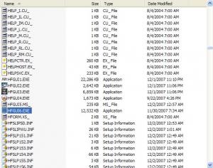

jimmsta Posted December 2, 2007 Author Posted December 2, 2007 Alrighty, I did the exact same thing on another machine, with 1.7.1rc2, without any drivers or anything that could cause the problem: This file is automatically generated by HFSLIP HFSLIP is for personal use only Copyright(C) TommyP 2005-2007============================HOW TO REPORT A PROBLEM============================ If running into problems, refer to http://hfslip.org/support.html HFSLIP support forum: http://msfn.org/board/index.php?showforum=129===============================================================================HFSLIP Version - 1.7.1rc2 build 71128aHFSLIP Path - C:\HFSLIP\Host OS - XPOS in SOURCESS - XP SP2 EnglishMSIE Version - MSIE7Drivers - DRIVER.CAB UpdatedCD Install Path - DefaultCDTAG - WIN51===============================================================================Files in your FIX folder:Files in your HF folder:NOREG\windowsmedia11-kb928788-x86-intl.exeNOREG\windowsmedia11-kb929773-x86-intl.exeNOREG\windowsmedia11-kb932390-x86-intl.exeNOREG\windowsmedia11-kb933547-x86-intl.exeNOREG\windowsmedia11-kb935551-x86-intl.exeNOREG\windowsmedia11-kb935552-x86-intl.exeNOREG\windowsmedia11-kb939209-x86-intl.exeNOREG\windowsmedia11-kb942264-x86-intl.exeNOREG\windowsmedia11-kb944110-x86-intl.exedirectx_nov2007_redist.exeIE7-WindowsXP-KB938127-x86-ENU.exeIE7-WindowsXP-KB939653-x86-ENU.exeIE7-WindowsXP-x86-enu.exeNDP1.0sp3-KB930494-X86-Ocm-Enu.exerootsupd.exeWindowsInstaller-KB893803-v2-x86.exewindowsmedia11-kb929399-v2-x86-intl.exeWindowsMedia11-KB936782-x86-ENU.exeWindowsMedia6-KB925398-v2-x86-ENU.exeWindowsMedia-KB911564-x86-ENU.exeWindowsUpdateAgent30-x86.exeWindowsXP-KB873339-x86-ENU.exeWindowsXP-KB885836-x86-ENU.exeWindowsXP-KB886185-x86-enu.exeWindowsXP-KB887472-x86-enu.exeWindowsXP-KB888302-x86-ENU.exeWindowsXP-KB890859-x86-ENU.exeWindowsXP-KB891781-x86-ENU.exeWindowsXP-KB893756-x86-ENU.exeWindowsXP-KB896358-x86-ENU.exeWindowsXP-KB896423-x86-ENU.exeWindowsXP-KB896428-x86-ENU.exeWindowsXP-KB898461-x86-ENU.exeWindowsXP-KB898543-v3-x86-ENU.exeWindowsXP-KB899587-x86-ENU.exeWindowsXP-KB899591-x86-ENU.exeWindowsXP-KB900725-x86-ENU.exeWindowsXP-KB901017-x86-ENU.exeWindowsXP-KB901190-x86-ENU.exeWindowsXP-KB901214-x86-ENU.exeWindowsXP-KB904706-v2-x86-ENU.exeWindowsXP-KB905414-x86-ENU.exeWindowsXP-KB905749-x86-ENU.exeWindowsXP-KB908519-x86-ENU.exeWindowsXP-KB908531-v2-x86-ENU.exeWindowsXP-KB910437-x86-ENU.exeWindowsXP-KB911280-v2-x86-ENU.exeWindowsXP-KB911562-x86-ENU.exeWindowsXP-KB911927-x86-ENU.exeWindowsXP-KB912817-v2-x86-ENU.exeWindowsXP-KB913580-x86-ENU.exeWindowsXP-KB914388-x86-ENU.exeWindowsXP-KB914389-x86-ENU.exeWindowsXP-KB916595-x86-ENU.exeWindowsXP-KB917537-x86-ENU.exeWindowsXP-KB917953-x86-ENU.exeWindowsXP-KB918118-x86-ENU.exeWindowsXP-KB918439-x86-ENU.exeWindowsXP-KB919007-x86-ENU.exeWindowsXP-KB920213-x86-ENU.exeWindowsXP-KB920670-x86-ENU.exeWindowsXP-KB920683-x86-ENU.exeWindowsXP-KB920685-x86-ENU.exeWindowsXP-KB920872-x86-ENU.exeWindowsXP-KB921503-x86-ENU.exeWindowsXP-KB922582-x86-ENU.exeWindowsXP-KB922819-x86-ENU.exeWindowsXP-KB923191-x86-ENU.exeWindowsXP-KB923414-x86-ENU.exeWindowsXP-KB923980-x86-ENU.exeWindowsXP-KB924270-x86-ENU.exeWindowsXP-KB924667-x86-ENU.exeWindowsXP-KB925902-x86-ENU.exeWindowsXP-KB926247-x86-ENU.exeWindowsXP-KB926255-x86-ENU.exeWindowsXP-KB926436-x86-ENU.exeWindowsXP-KB927779-x86-ENU.exeWindowsXP-KB927802-x86-ENU.exeWindowsXP-KB927891-v3-x86-ENU.exeWindowsXP-KB928255-x86-ENU.exeWindowsXP-KB929123-x86-ENU.exeWindowsXP-KB930178-x86-ENU.exeWindowsXP-KB930916-x86-ENU.exeWindowsXP-KB931261-x86-ENU.exeWindowsXP-KB931784-x86-ENU.exeWindowsXP-KB932168-x86-ENU.exeWindowsXP-KB933729-x86-ENU.exeWindowsXP-KB935448-x86-ENU.exeWindowsXP-KB935839-x86-ENU.exeWindowsXP-KB935840-x86-ENU.exeWindowsXP-KB935843-x86-ENU.exeWindowsXP-KB936021-x86-ENU.exeWindowsXP-KB936357-v2-x86-ENU.exeWindowsXP-KB938828-x86-ENU.exeWindowsXP-KB938829-x86-ENU.exeWindowsXP-KB939373-x86-ENU.exeWindowsXP-KB941202-x86-ENU.exeWindowsXP-KB943460-x86-ENU.exeWindowsXPMediaCenter2005-KB900325-usa.exeWindowsXPMediaCenter2005-KB925766-ENU.exewmp11-windowsxp-x86-enu.exeFiles in your HFCABS folder:LegitCheckControl.cabMUAuth.cabMuCatalogWebControl.cabMUWEB_SITE.CABswflash.cabFiles in your HFSVCPACK folder:0_dotNET11SP1.exe1_dotNET20SP1.exe2_VC2005SP1.exe3_J2SE603.exeFiles in your HFSVCPACK_SW1 folder:Files in your HFSVCPACK_SW2 folder:Files in your HFGUIRUNONCE folder:010_dotNET35-Lite.exe4_ISScript.exe5_OtherRuntimes.exeImgBurn2320.exeUPHClean-Setup.msivcpack.exeFiles in your HFTOOLS folder:7za.exebbie.exebbie.licBOOT.BINcWnd.exeHFSLIP_POST_getnewfiles_v3.cmdHFSLIP_PRE_TZ3.CABHFSLIP_PRE_TZ3.CMDmkisofs.exemodifyPE.exeMSICabExtract.exeRar.exereg.exeUnRAR.exeFiles in your HFAAO folder:ProgramAddons 7-Zip 4.56 Beta.cabProgramAddons CCleaner 2.03.532.cabProgramAddons DVDFab Decrypter 4.0.1.2.cabProgramAddons Firefox 2.0.0.11.cabProgramAddons Notepad%2B%2B 4.6.cabProgramAddons QuickTime Alternative 2.1.1.cabProgramAddons VLC 0.8.6d.cab===============================================================================HFSLIP run time: 19m42sThe files that you asked for before, for this build: attempt2.zipThis time, I decided to do a test in VMWare before burning another dvd. Here's what shows up: I looked in the directory, and found that this time, HFGUI6.EXE is the same file from the previous file, which is VCPack.exe, a silent installer for the Vista Codec Pack. So, it seems that it's some wacky problem with vcpack.exe and hfslip, or something. It otherwise works fine, except I get the funky error that the file wasn't copied properly, yet it runs during setup, so it obviously copies fine. :?
Tomcat76 Posted December 2, 2007 Posted December 2, 2007 Well, there you go. Either the file got corrupt (try downloading it again) or you need to run modifyPE.exe on it before running HFSLIP:modifype.exe VCPack.exe -c
jimmsta Posted December 2, 2007 Author Posted December 2, 2007 I did another build without the file, then I added it in with nLite- no problems occurred during windows setup. Strange, if I do say so myself. I'll just leave that out for now, and see if there's a known issue with the file needing the checksum corrected. Thanks for looking into this.
Tomcat76 Posted December 3, 2007 Posted December 3, 2007 I think that the problem is just that the file doesn't like to be renamed. I suppose nLite doesn't rename it.
