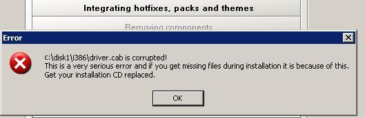

finally i downloaded the latest version of nlite v1.4beta, and when i tried to integrate ryanvm's update pack v2.1.11 using it.
During extraction of driver.cab following error message is pop up.
  • Author

But no, If i ignore that error, during setup following files unable to copy, which should be in driver.cab normally, but unfortunately if we ignore above error these file will not in driver.cab more.
kodak_dc.icm,srgb.icm,streamci.dll,tosdvd.sys,tsbvcab.sys,tsbyuv.dll,usbcamd2.sys,usbcamd.sys,vdmind
d.sys, wowfax.dll,wowfaxui.dll,usrcntra.dll,usrcoina.dll,usrdpa.dll,usrdtea.dll,usrfaxa.dll,usrlbva.dll,usr
lnka.exe, usrprbda.exe ,usrsvpia.dll, usrv42a.dll,usrv80a.dll,usrvoica.dll,usrvpa.dll
and during setupbillboard a dialog box appear containing error with streamai or similar.
