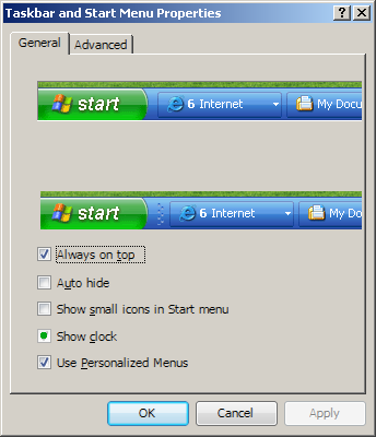

I only had buttons, toolbars, and explorer tabs turned on since I'm still trying to hunt down Explorer instability issues, but this is what I got. I didn't make any changes, I simply put the .INI in the skins folder, and put your images in a "Skins\test" folder. I'm using SmoothText 1.0.0, but for this there is no difference from 0.9.9. This is a Win2k laptop, but it had XPize run on it in the past, which is why the taskbar graphic is different.

Just a little update...my main development desktop is down until I get my monitor back from service. In the meantime, I'm working on SmoothText 1.0.0 on my laptop. I don't have the Firefox 3.5 bug fixed as I'm not running it on my laptop (and I don't want to switch just yet on it), but I have checkboxes in for turning on and off overriding some of the Windows controls (e.g. buttons, static controls, list boxes, etc.) This will give you more control over how SmoothText overrides things and might help narrow down Explorer problems. I've also changed the order of initializing the skinning engine vs. initializing the overriding controls behavior, and this seems to help with Explorer a little. Finally, I've started adding support in the skinning engine for changing the system colors. Each skin can specify which system colors to change, and SmoothText will change them when it starts skinning. It will, of course, change back to your original colors when it exits. I also fixed a bug in taskbar skinning where the taskbar background wasn't being painted properly. Here is a small screenshot with SmoothText managing my system colors:
