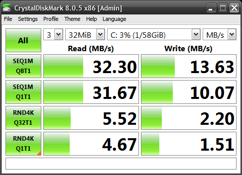

Hey Dietmar, thank you. You rule. The Ramsey USB mode worked and I was able to install from a CD directly to a USB drive on the target laptop. I had some problems booting. After the first stage I got a flashing cursor. Grub4dos helped with that. Now the system is fully functional! but there are some remaining questions, namely, Should I have a pagefile? Upon boot it complains about it not existing, despite the option being set correctly. It seems that the system can't create it because it actually detects that it is being run from a removable disk (C:\ has the removable disk icon). The sequential write speed is too low (6-10 MB/s) for a USB drive, but the read speed is on par compared to a regular 2.5" IDE HDD speed (~31 MB/s). Should I enable write caching on disk? (Optimize for performance). I did but it doesn't help with the write speed test. Any other tips?
