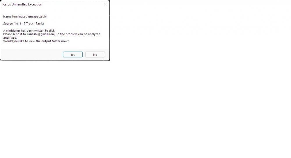

[1688] StartIsBack: forbiding XAML launcher to start [1688] SIB ASSERTION FAILED SysTray.cpp:332 [1688] Jumplist populated in 8 ms (system pane items 5 init 14 ms) total 27 ms [1688] Jumplist populated in 89 ms (system pane items 40 init 14 ms) total 143 ms Ok... so i manually forced closed explorer, reloaded it to test more. This time I got the Icaros popup without explorer crashing. Right clicking about a dozen times eventually caused the right click menu on the start button to stick & stop working. The rest works fine however. No crash/dump yet on this try. -

This new version accurately replaces the taskbar and start menu... I do get the occasional explorer crash-dump I never had before, after right clicking the taskbar. the dumps vary, they either points to heap corruption, or to k-lite's thumbs. Crash dump is created and a k-lite popup appears asking to send the dump to their side. Right clicking the taskbar was what triggered the crash. Right clicking the start button never did. But now after a crash, right clicking the start button shows no menu. Left clicking works however. The button appears permanently in the pushed position. -

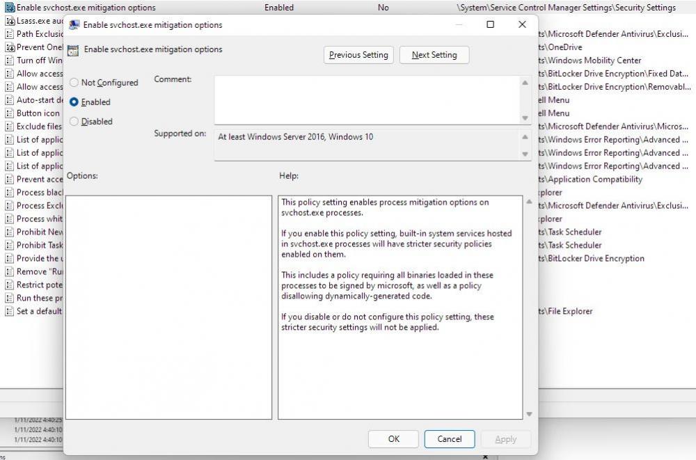

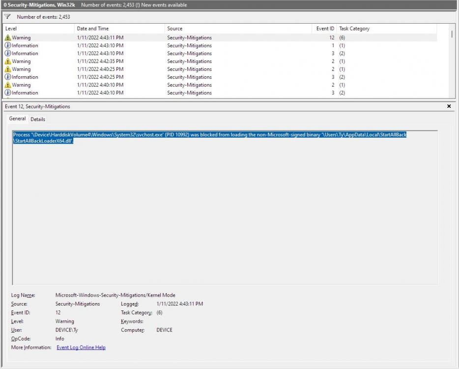

[Solved] Installing StartAllBack 3.2.1 Windows 11 22000.376, Crashes Explorer
boji replied to boji's topic in StartIsBack+
Not loading a non Microsoft binary is "Code Integrity Guard" in MS exploit mitigations. The mitigation for preventing dynamically-generated code is "Arbitrary Code Guard" -
