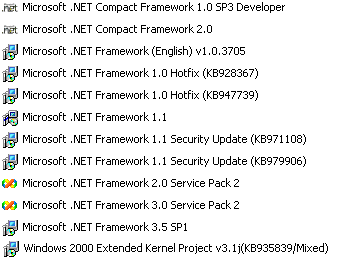

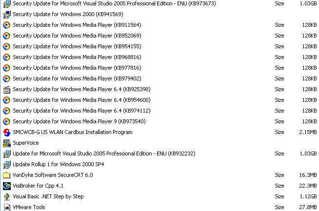

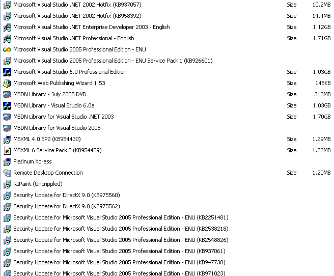

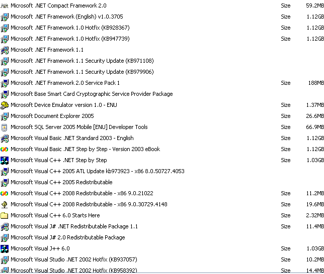

	Yes and No, I was trying to figure out if it would be the cause of .....It does not matter if the kernel is installed the popup messages happens anyway. Yes I am checking my add/remove now. Is NETFX40W2Kv2.wlu, .net framework??

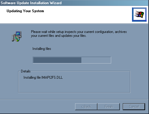

	space popup is gone now,. installed NETFX40W2Kv2.wlu - ok. I do not see it in add/remove though..? NDP40-RollUp.wlu and NDP40-RollUp-v2.wlu gives . I am trying to install the extended kernel now. -* Ok space issue has gone away with the updated exe files. For whatever reason I keep getting it requires .net framework..
	thats is interesting. its says .net 4 frame work ready to complete to install. so it is not installed because it is not in the add./remove. unless I need to install it twice. I'm going to see if I can still find it on legacy update. Updating my .net files... While this installer perpares the windos2000 to install .net 4... Will try a reinstall once updated.

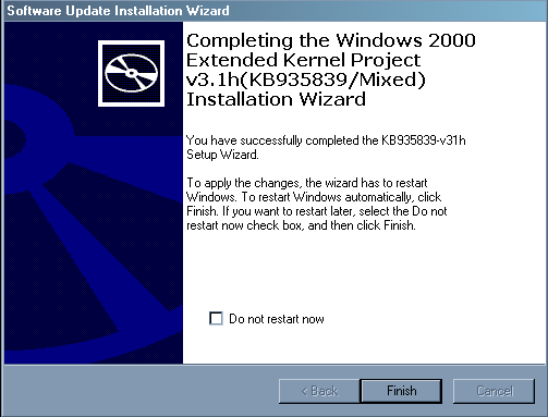

	installed net 2v2 NETFX40W2Kv2.wlu. will not install first NDP40-RollUp.wlu- disk full then NDP40-RollUp-v2.wlu? - requires .net frame work 4 installing new kernel..... installed once. Windows2000-KB935839-v31iM-x86-ENU.wlu rebooted, didnt notice a popup ngen message. will not install. second try. first NDP40-RollUp.wlu- disk full then NDP40-RollUp-v2.wlu? - requires .net frame work 4

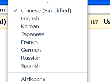

	I tried searching for the string without success. I also get a failed translate message because of server. Is there a way to restore functionality? Function: Drop Translate to English from Chrome mode page context menu (1 occurrence) replace: C0 FB 8D 86 F0 02 00 00 50 E8 with: C0 FB E9 E6 00 00 00 90 50 E8

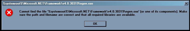

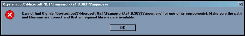

	ok even with .net 4 installed the ngen error pops up.. i'm going to look at Sylpheed-3.7_setup.exe client more closely now.

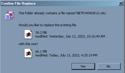

	im not sure what happened but the .net 4 frame work i downloaded on wluen is smaller then the version i downloaded on http://blog.livedoor.jp/blackwingcat/archives/1707344.html..

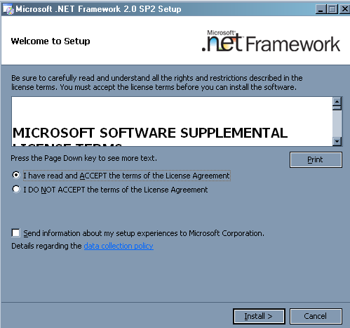

	downloading the .net 2.0 sp2. using wlu 1.5b now... now .net 4 sp4 installed, i will install Windows2000-KB935839-v31hM-x86-ENU.wlu, 1st install ok, 2nd install ok..waiting for reboot. same ngen error with .net 4 installed. big difference in size. overwrote it. will try installing it once .net 2 sp2 is installed. Installing .net 4 sp2..start..working

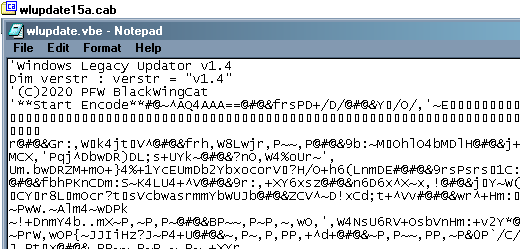

	I thought I was running v1.5, but appears I have version v1.4. I'll have to look for v1.5.. http://win2k.org/cgi-bin/dl.cgi?file=wlupdate15b.cab http://win2k.org/cgi-bin/dl.cgi?file=wlupdate15a.cab Bad GateWay If you don't use thedirect link, please change security level down at this sit
	Thanks I did not see that. Windows2000-KB935839-v31hM-x86-ENU.wlu Going to try it. No .net error on install. rebooting..gonna to try again. .net error on second install. I have windows 2000 on my second partition as drive D: I still cannot install .net wlu files. I'll look at the email clients...

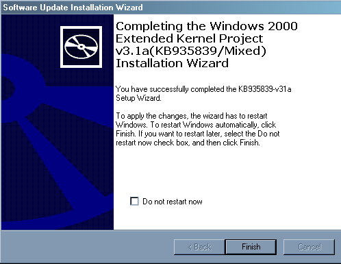

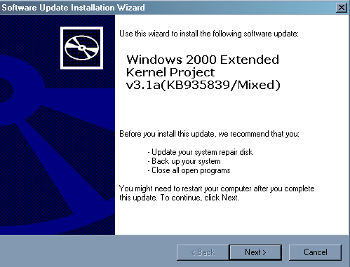

	I've installed v2 rollup update, 2: Windows2000-KB935839-v31aM-x86-ENU.wlu 53951 KB "twice default", all mvs runtime. I still get the ngen .net 4.xxxx. error once on reboot. none of the .net 4 installs, will install.

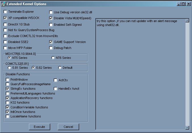

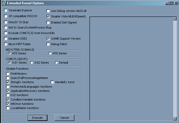

	I understand. Before anything letme try configuring sylpheed email client, doesnt appear to support OAuth2. will look at this more later. Appears I am missing ngen .net 4.xxxx. *- Second reboot .net error went away. maybe because I i nstalled the mvs runtimes? *- The api-ms-win-core-libraryloader-l1-2-0.dll File is a DLL (Dynamic Link Library) System File provided by Microsoft for Windows 7 wondering if nt6 config would fix this or should i change 5.82. -nt6 did not work. xpwinsocket and 5.82 not work... Where can I find MVS2019 runtime for Windows 2000. Assuming this is version 2. after installing the Windows2000-KB935839-v31aM-x86-ENU twice i got this. what options should i enable? I left the default and hit excute. what version of MVS is does becky need? or is this error from broken .net. I installed all these and becky still gives the same error. I will reboot,

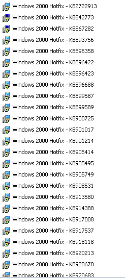

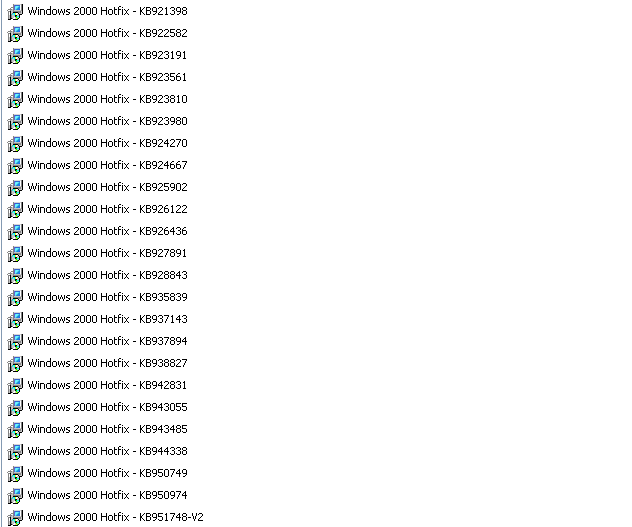

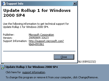

	Are these the files I suppose to install. Does the extended kernel get installed first or the Update? I did the update first, IE updates then the kernel. 1: windows2000-kb891861-v2-x86-enu.exe 31,958 KB and Update Rollup 1 for Windows 2000 SP4(v2) appear to be the same file. "rollup v2 for 2005 english": 2: Windows2000-KB935839-v31aM-x86-ENU.wlu 53951 KB 3: For Now. becky older version loads, will try newer version shortly. Becky 2.8.1.4 doesnt load.
