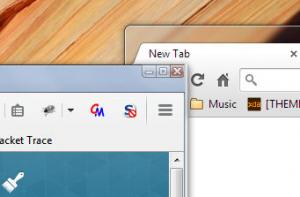

Hurray! That was it! It works now. Donation on the way ... BTW Is glass application-dependant? Firefox refuses to be transparent. Here is in comparisson with chrome

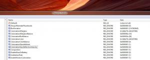

Guys, is not working :-( I have corners and glow but no transparency. I checked manually and also executed the above script. Here is what I have now in my registry. You can also see that my window frame is not transparent. I run "classic start menu". But I do not think this creates my problem. Can you point to a theme that you know it works?
