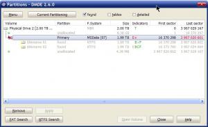

  4. Hello, Jaclaz! Are you still there? I moved the hdd from NAS to the main PC and I can begin the imaging, but I don't know exactly what parameters to choose from DMDE "Copy Sectors"-window. There are "Device", "Partition", "File". Is it better to do a "clone" and does I have to format the destination hdd, or DMDE will do this? I ask because I formatted to NTFS the destination hdd under Win7 on my secondary PC, but when I moved it to the main PC(with XP) the disk manager shows "GPT Protective Partition". What to do with this GPT partition? Should I delete it and format again(using third party software) to MFT ntfs, or just to run copy with DMDE?

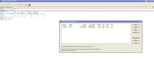

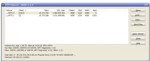

  8. You at first wrote that 2 TB HDD will be enough and now - won't be enough? I already was thinking about buying a 4 TB HDD to put it into last free slot in the NAS. I know that more than 2 TB won't work with XP, but right now I can't exchange XP with 7... I think the file system for my NAS is ext3 or ext4. Because of the low network speed(I use a cheap router) I agree that it maybe would be better to mount this HDD in the PC. But then I will have to format and align(or reversely) it. So if only the speed will be the problem here, and not the space - I will copy through the LAN. I'm not very comfortable with command line tools. Would you tell me how exactly to get those 100 sectors with DMDE? $Noname02 $MFT - LBA 16373784

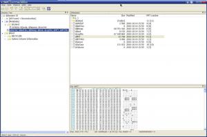

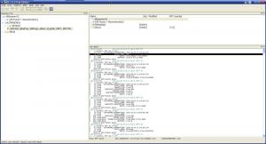

  10. Sorry but now I can't upload another screenshot - "You can upload up to Uploading is not allowed of files (Max. single file size: 100MB)" - don't know why. In $Noname02 I can't see nothing under MetaData and $Root. Instead in $Noname01 I see what I uploaded already.

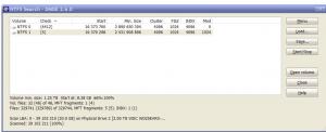

  11. Yes - when I initially mounted this HDD, I used the tool(Acronis I think) recommended from WD to align the partition from 512 b to 4 k - I use 32 bit OS. I don't see nothing on NTFS0. On NTFS1 $Root I see only RECYCLER and System Volume information. In the Metadata I see 14-oct-2010 - the date I bought the HDD. In NTFS1 $MFT I see this:

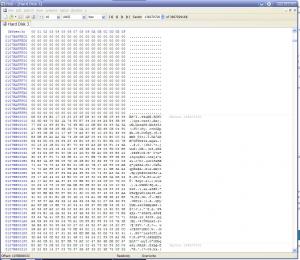

  12. I mounted this HDD many months ago and I don't remember - I guess it is possible. From HxD I saw that there are symbols from sector 77453312 to 93916713 and from 138270720 to 3907024064 and also in the first sector. ntfsscan.log.txt

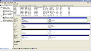

  13. OK - I will try again. I had 2 partitions - G and H on WD20EARS. The first one was 8 GB and not formatted. I didn't want to see the letter for that partition so I decided to delete it from the Disk Managemen tool in XP. Then the second - ntfs-partition disappeared. I loaded Parted Magic but didn't write nothing to HDD. In the past I managed to recover accidentally lost partition with MiniTool Partition Wizard so I used it again. Then I ran Wizard - Partition Recovery Wizard - I don't know if this is some kind of formatting... It definitely didn't take hours - I think it is the first or second case. I didn't perform reading/copying "key" sectors - don't know how. There are only Zeroes on sector 22661691. The symbols begin at sector 138270720.

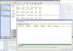

  14. I have some LOG, but I don't know if this is enough or I should go further with TestDisk actions. OS is XP 32 bit and I used the standard tool - Disk Management. According to TestDisk the main partition should start at sector 16370235 and end at sector 3907024064. I tried to recover the main partition with PartitionWizard - Partition Recovery Wizard. It showed start at sector 16370298 and end at 3907020601. Does this mean that I should go for file recovery and not partition recovery? I was hoping that if I resize this now looking empty partition to it's correct boundaries... "First check you should make would be to use a disk viewer/editor and verify that absolute sector 22661691 is the actual start of $MFT ." - PartitionWizard shows: Partition type ID: 0x7 Serial Number: 0x1cb6bb8c1f403a0; First Ph sector: 16370298; Last Ph. sector: 3907020601 - Is that you ask for? Should I try to make a copy with Data RescueDD? I have a NAS and I can use one 2 TB HDD that I have there. testdisk.txt

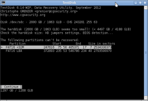

  16. The analisys says - "The harddisk seems too small" - 4497 GB. There are two FAT16 partitions and I don't know where they came from.
