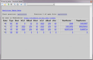

	  Invalid Partition Table on my 500GB HDDklinsmann replied to klinsmann's topic in Hard Drive and Removable Media Yep, that's the tricky part. See what the Atola tool has to say, first thing (remember that it is just a "semi-random guess" that the drive self-capped ). http://blog.atola.com/restoring-factory-hard-drive-capacity/ whether tool will work under 7 and particularly under 7 x64 is up to you to find out. jaclaz OK, so I managed to make the Atola tool work (had to try on a 32-bit version of Windows 7). Things seem to be getting trickier by the minute...

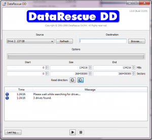

	  Invalid Partition Table on my 500GB HDDklinsmann replied to klinsmann's topic in Hard Drive and Removable Media Well, what most people tend to confuse is file format with file extension. What you made with datarescue.dd is a RAW (file format) image, i.e. an exact, byte-by-byte, sector-by-sector, image of the source hard disk. You can give it *any* name, and as well *any* extension, like .dd or .img, it will still remain a RAW image. If you prefer the extension given to a filename has two scopes: be a "mnemonic" to quickly know what file format it is (of course only useful if you give appropriate extensions) be useful for associating those files to a given program for all it matters you could name the image mynicespreadsheet.xls (only Excel will choke if you attempt double clicking on the file ). So that's done Which process? If you dd the 137 Gb image to the 1 Tb disk you need NOT the original disk connected. On the other hand if you already recovered most of the files from the "capped" hard disk or from the dd image, you may want to "skip" this part (you already have the image, so if needed you can do this later) and check just the "failed" disk with the Atola tool. Unless *somehow* we change something in the failed disk, the accessible data will still remain the 137 Gb you already imaged. "Restoring" the dd image to the "new" disk is simply an approach that allows the use of CHKDSK and TESTDISK on a "full sized" space, which may (or may not) help to fix the filesystem/access the files IF you did not managed to already save them (anything beyond the image size will remain anyway "a suffusion of yellow"). By "the process" I meant this whole thing. OK, so original Hard Drive is right now disconnected. Easiest? Create a small partition on the disk and format it. Open tiny hexer, FIle->Disk->Open Drive, you wil normally see something like (example): The right PHYSICALDRIVE is the "parent" of the drive letter assigned to the newly created partition. jaclaz I seem to be having an issue I did not have last time I used Tiny Hexer (check atteached image). Thanks (as usual) jaclaz! Edit: dsfi is denying acess when I try dsfi \\.\e: 0 0 SOURCE (SOURCE being of course the actual source file I renamed to .img)
	  Invalid Partition Table on my 500GB HDDklinsmann replied to klinsmann's topic in Hard Drive and Removable Media So, I finally found the time to fully get into this and get it solved ASAP. I imaged the disk with DataRescue DD, however the images is a .dd file. How can I turn it into a .img? I have saved almost everything in those 137 GB, but as you predicted, some partial data is damaged (a few random files are shown as corrupted). This is how I've set up the PC for the process: a 1 TB SATA Hard Drive connected through USB, and the "corrupted" Hard Drive we are trying to save directly plugged into the MB. Is that alright? What should I do now? Edit: Forgot to ask, what's the safest way to know which PhysicalDrive is the 1 TB drive I'll be using with dsfi?

	  Invalid Partition Table on my 500GB HDDklinsmann replied to klinsmann's topic in Hard Drive and Removable Media Let's try and answer all the questions: Image saved and I already managed to save all the necessary info on those 137 GB. I'm guessing the missing data will be located on the "ghost" sectors on that partition. No problem about that, I have a 1TB drive I can use for this purpose (is it OK if I just use this one?). 1. HDD is a Seagate ST950032 5AS (2.5" SATA drive) 2. Laptop is an ASUS-X52J (Core i5) 3. This happened last friday, I started looking for solutions on monday and so far I've managed to save 137 GB of data (which counts for about 60-70% of the vital data stored on that drive). 4. I am currently accesing the drive through a USB to SATA adapter connected to a desktop PC with Windows 7. Tried connecting the drive directly into the PC motherboard through SATA but the LBA48 issue with TestDisk was still there. Thanks jaclaz, let me know what else you might need

	Hi there everyone, I've been going crazy over the past few days trying to recover my laptop's HDD. I read the whole thread regarding a similar problem on the same HDD model: Problem is that I have a few partitions on that HDD, but I can only access one of them. This is basically my HDD's layout: * RECOVERY partition (came with the laptop) > Accesible * Windows 7 x64 partition (F:) > Shown as RAW, 137GB (partition is actually larger than those 137GB) * Ubuntu partition (+ SWAP partition) > Not showing, don't care if it gets lost Following the steps given by jaclaz I get to find the StartSector of each partition with PTview, but I don't know how to go on from there. I have already installed Tiny Hexer (+ scripts), HDHacker and DataRescueDD. Testdisk won't let me access the W7 partition as no LBA48 support seems to be available for this HDD. What should I do now? What info should I post here in order to solve this issue? Any help will be MUCH appreciated, I will definitely try to help out from now on and become part of this community. Thanks a lot Edit: Added the PTview info on the HDD, and DataRescue DD + Tiny Hexer "Open drive..." screenshots
