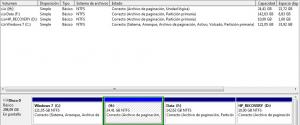

Hi and thanks again for the reply... And oops! I allready did do the "Write MBR" thing. I then tried to install xp again but the same thing happened: "invalid BOOT.INI file..." the first time the setup restarted the computer. In other words it didn't make any difference at all. I again used the Windows 7 recovery disc to fix that so it boots OK from Windows 7 again. And no I no longer have the Windows XP option in the bootloader. I deleted it again (using EasyBCD). So now I have the options I always had: Windows 7 or Ubuntu when I start up the computer. As I said the XP installed fine but since I tried to reinstall it I formatted the partition (H) again during the XP instalation. So now I have an incomplete windows XP on the H drive. I attached a screenshot of the Disc Manager. I hope that answers your question about the order of the partitions. And currently I don't seem to have ANY file named BOOT.INI on any of my partitions. Where is it supposed to be?
