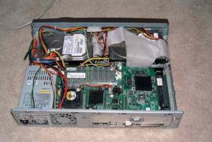

  16. -the cpu overhead for running the raid is about 12% considering that this box's primary function is data server this never runs at full capacity. -the laptop drive is a 7200rpm seagate drive with 8mb of cache, it is the highest performing drive in the box. -all cables are snug -UDMA is enabled on all drives -all unneeded services are disabled - i am using the built in raid because i dont have any PCI slots. i only really expected a slight increase in speed, not a decrease -your right about the benchmarking; i didnt do it on this board so that might be a factor but i did use the same utility (sis sandra, same version on everything) -i run 2003 because i had a free copy and im practicing for my MCSE testing on it. since its 98% file server im not worried about that much overhead -the picture does not show it but i have a fan in the rear blowing air in across the board and another fan in the lid (not pictured) that sucks the hot air out. the exaust is directly above the drives and their are air vents between the drives that because of the suction on the exaust fan, suck cool air thru the drives from every side. (i was real proud of that) -il take your advice on the IDE cables, perhaps some custom ones (friend has the tools)
  17. I made mysef a server out of a gutted tivo box. i used parts i had at my house already to keep the overall cost down and heres what ended up inside. keep in mind that this is only serving 2 computers in my home and extreme performance is not a priority 850mhz celleron on unique mini motherboard with dual 100 NIC 256 mb sd ram pc 100 (thats maxed) 3x 80 gb hard drives (2 IBM and one WD) 40gb laptop drive (for the system drive, low power always on) Geforce 2 video 16mb PCI card running server 2003 i crammed it all into a tivo box and configured the 3 80gig drives to run in a RAID 5 via dynamic disk in windows. since the drives are IDE i figured i would get like 50mb/sec out of them since individually i was able to pull 40mb/sec as a baseline test. but after all was said and done i was only able to pull 23 mb/sec out of the Raid. write caching and enhanced performance is enable on all drives (its running on a UPS) and the drive tempatures peak at 140 f on the IBM's. how can i bring the performance back up or diagnose any problems i might be missing?
