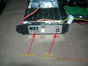

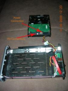

Two point JFYI: you DO NOT want an enclosure you DO NOT want to add an extra layer of possible problems (the USB connection) However, if you are going to use the USB interface, get a "free" one, examples: http://cgi.ebay.com.sg/New-USB-to-SATA-Con...=item3a53b43d76 http://cgi.ebay.com.my/ws/eBayISAPI.dll?Vi...em=260477902803 jaclaz The USB cable is not used or connected. It is used simply to power the Seagate hard drive during the code sequence. -
The Solution for Seagate 7200.11 HDDs
Twittwilly replied to Gradius2's topic in Hard Drive and Removable Media
I don't quite understand. How do you make connection to the power cord if you can't attach it with the mounting tray out of the enclosure? Just push the tray back in with the drive mounted on it and slightly add pressure until you feel the drive connect? If this is correct, in that case you have to get a male to female SATA power cord....which they should have at the same store. Failing that, I would return the enclosure due to the fact you were misled by the individual who made the recommendation to you. I have the Acomdata Samba Sata/Pata enclosure which has all drive connection wiring (with the simple pull-off removal of the top metal covering on the tray) and the power switch/AC adapater plug/usb connection on the slide-out tray itself. It allows easy access to the pins and does not require re-insertion to the enclosure cover. Amazon has them on sale here: http://www.amazon.com/dp/B000VNJD1S/ref=as...ASIN=B000VNJD1S -
