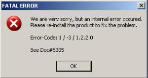

Hi All, I've tried several ways to achieve the silent installation of Nero 9, including the one in this post. But sofar it's unsuccessful because once I import the registry keys for the serial I get the following error: If i initialize setup from setupx then everything is working just fine and the serial is not a problem either. So I don't have a clue right now of as where it goes wrong and haven't found a solution after reading all day about it. I assume I'm missing something. Hope someone can shed a light on the subject. I used the following folders from the extraction: Unit_app_4 unit_app_30 unit_app_61 unit_app_63 unit_tpi_imagxpress-7.0.74.0 unit_tpi_lightscribe-1.14.17.1 Also left setupx.exe, setup.xml and ipclog.exe in the same root folder as these unit_app folders. Would be very greatfull.. -
