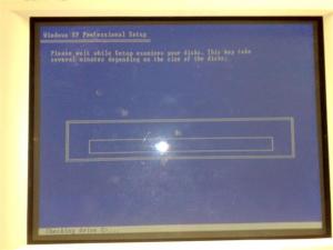

I just tried renaming the Migrate.INF file to try your other suggestion above but i get the same issue. The error above is generated directly after it says its checking the C: drive, it doesnt show any partition information. -

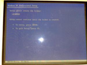

Hmmm it seems i spoke too soon. It was prompting for partition info (as intended according the answer to my last question) when using my 1GB USB Stick. However when i use my 8GB stick which then contains 1 additional folder within $OEM$\$$ that contains other application files for later installation its giving me an error saying its unable to create \Windows prior to trying to copy files to the hard drive at the start of the text based installation Im guessing from reading other info, its working on the 1GB disk because it doesnt have enough room to install Windows and therefore prompts for another location to install and the 8GB has enough room so there is no prompting, which leads me to think that its trying to install on to the USB Stick when using the 8GB. Its probably worth noting that this machine does not require any F6 additional drivers to install and will happily proceed with installation with whatever is shipped on the CD as standard How do i correct this issue? -

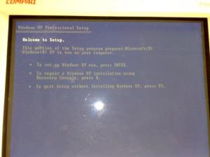

Hi, im having an issue with the USB stick. I've got a DVD setup and working perfectly doing the unattended setup in full for me. However, when i use the source files for that disc with this tool, it no longer runs fully automatically. Its now prompting me to choose which partition to use and then do i want to format it etc. Ive not altered the WINNT.SIF files at all after the tool has created the USB Stick and ive confirmed the [data] section has the Autopartition=1 and Unattended="Yes" WINNT.SIF [DATA] section shown below [Data] AutoPartition=1 MsDosInitiated="1" UnattendedInstall="Yes" floppyless="1" winntupgrade="no" win9xupgrade="no" EulaComplete="1" Ive then answered the partition questions and allowed the process to continue and the rest of the installation appears to run unattended as intended. I have read through here a couple of times but most times its been late so its possible ive glossed over the answer to my problem. Any help would be appreicated though! Thanks and keep up the good work, your work and this site as a whole has so far proven invaluable!
