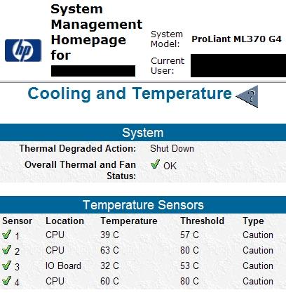

I love the program SpeedFan where you can control the fan speed and see tempratures on the hardware! Now Im using a HP Proliant ML370 G4 Server as my workstation B) The problem is that when SpeedFan can only find a sensor on the ISA bus that shows just 8C which of course is wrong.. I put a report in SpeedFan bug tracking system and he could not find the sensor from the data I send to him. The same result also happens even if I tried many other "Hardware Information" programs that also can check for sensors. Here are some I tried: Core Temp 0.99 CPU-Z 1.45 CPUCooL 8.0.7 Dr. Hardware 2008 Build 9.0.0e EVEREST Ultimate Edition 4.50 GPU-Z v0.2.3 HARDiNFO 2008 Professional 6.00 Build 3150 Hot CPU Tester Pro 4.4.1 HWiNFO32 2.30 HWMonitor 1.10 (32-bit) Intel Thermal Analysis Tool MobileMeter 0.3.1.0 Motherboard Monitor 5.3.7.0 PC Wizard 2008.1.85.2 PerformanceTest 6.1 Real Temp 2.60 Sandra Lite XII.2008.SP2c (14.24) SIW 2008-10-28 SpeedFan 4.35 SysTool Build 731 The annoying thing is when I use HP's System Management (a local webpage that show information) It shows something like this picture, which shows that there should be normal sensors to get info from! Is there someone or know some program who can get info how or where these sensors are? Thanx! /Coop
