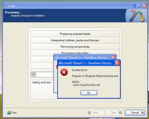

  1. today i try use nLite integrating drivers, the Runtime error come out. my computer = fresh install windows XP + Microsoft .NET Framework 3.5 SP1 i post the screen capture here. when process starting the driver part sure pop out error. anyone have any idea, thanks.

    Thanks your reply, i found a Nightlies version of MassStorage, DP_MassStorage_wnt5_x86-32_810H, this package have support HP's CQ-40 notebook chipset ATI SB7xx. Try first, tell you latest result. thank you.
