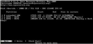

I seem to have conveyed the wrong meaning there The screenshot was that of the "Partition table recovery" step , and i obviously didn't dare to "write" (as u can see from the screeshot i selected quit) . I only meant to say that I'd have to do the "deep analysis" again for another ~5 hrs and then set all the partitions to respective parameters again to do the recovery. btw i did restart my PC to check if the other partitions were available and also a ran a test on a rar file to see if anything is wrong. ALL is good as of now -

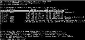

I should've set the other partitions to their respective values as well, coz i got this when i tried to write the partition table. The most boring part is that I have scan all over again :sigh: Nice software though i wish it would've been great if it had "back" option for all screens and menus. -

Yep, that's a bit misleading coz I don't know where the "Linux" partitions popped up from, and also all the partitions are marked as "D" - deleted, whereas in reality only Two are deleted "movies" and "[backup n Workshop]". Apart from the Linux Partitions , Yes. Yes & yes. I did check the files , and they are right there. I've got one more question. What do i do for the rest of the partitions , which are also marked as deleted, but are actually present correctly in windows ? If I mark only the last partition as Logical and leave others as such it may delete them while I write the partition table. On the other hand , setting other partitions again to appropriate designations (primary, extended etc) *might* screw up existing partitions as well. -
