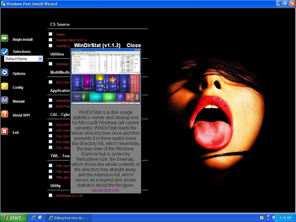

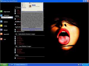

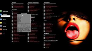

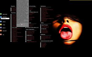

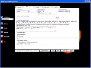

yeah, that's what i thought those were for, but it doesn't seem to work for me. the image in my last post, i had the width set at 10 and the height set and 5. Style[0]=["white","black","","center","","4","black","gray","","left","","3","10","5","3","black","2","24","0.5","","","","3","","",""]; here's another image of what it looks like i get the same results no matter what values i put in there. the only way the box gets bigger is if i make the font size larger --------------------------------------------------------------- ok i see now... i need to use BIG numbers. -
This is the problem im running into. It seems the widest i can get it, is the largest size allowed for the tooltip image (256). it doesn't seem to have a problem adjusting vertically, but as u can see, it cuts off in a few of them as shown in the example. How can i make the tooltip box wider, OR get it to stay within the screen size and not be cut off. thx
Just wondering if WPI already has these options integrated. I read in the forums something about it going to be added, but i havn't seen anything else about the topic after that. If so, where/or how would i enable that option. thx

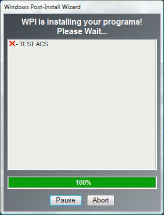

i hope this is what u were asking for. ;The comment below contains SFX script commands Path=CAL SavePath Silent=1 Overwrite=1 Shortcut=D, "CAL ACS.exe", "", "", "CAL ACS" Shortcut=P, "CAL ACS.exe", "CAL League Files", "", "CAL ACS" also, should i leave out the .sfx and just have the filename as "cal acs.exe"? ---------------------------------------------------------------------------------------- i tried it and i got this when i double clicked the file i made ---------------------------------------------------------------------------------------- ok, i extracted the app i made in winrar and added that extrated file into my install folder. no more nasty messages, but it is not installing. WPI gives me the red X for failed install. -

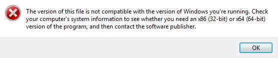

I was going to download cal and make you a nice pretty installer and icon for it. But the only site I could find it at you have to register to dl it... ah, i see. Well, thanks for the info, didn't know winrar could do all that. i made the sfx package, but what is the command that i use in WPI? is it the same one i've been using for the other applications? cmd1[pn]=["%wpipath%\\Install\\CAL\\CAL ACS\\cal acs.sfs.exe"]; when i install this through wpi, i get An error has occurred in the script on this page. Line: 380 Char: 26 Error: Permission denied Code: 0 URL: about:blank but when i install this through wpi with just the application file it works fine. do i have to run this as admin maybe? -

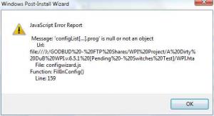

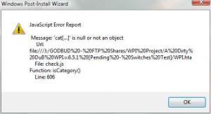

now im getting errors i passed my mouse over my BORGChat application in WPI and in the tooltip, it was X'ed out, so i went into the config file and i did not have the path to the folder set to either the install or the image. So, i did that. That is when i started getting all these errors. This is the error i get when i try to launch WPI I do not have any categories. this is all i see when i select the drop down box This is the error message i get when i exit out of the Config tab here is my config file config.js thx for ur time

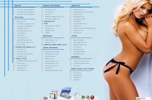

Here's a couple i'm working on Im looking for a nice WPI logo that will blend in with these backgrounds. Most of them have the globe. Are there any with a moon to match the darker themes? well, hope u enjoy need to make the tooltip box wider and figure out how to get the pictures to work I like this one. Looks simple and clean with the dock on the bottom. Too bad the tooltip doesn't work with this theme though. It was originally the "Vista" theme that modified. I plan on placing my WPI on my web server for friends and family to access. Im pretty much trying to make a SUPER WPI. Does anyone know if there is an ongoing project of that sort? If so, i would like to contribute what i have to add to the cause. If not...lets start one!!!!! Maybe end up with a WPI folder that over 1TB LOL (mines almost at 3 gigs and i just started)

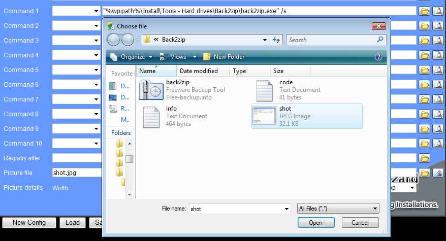

i have run into 2 problems which don't seem like much trouble, but i have no idea what anything is and i'm seeing spots now from staring at my monitor for so long. 1. The tooltip box is cut off. I have been trying to expand the width for it to no avail. it seems to automatically set the size depending on the length of text inputed, however, it only compensates and adjusts on the y axis of the box. i can't figure out how to make it wider. its at about 2 inches wide. i would like to make it about 4 inches. 2. My pictures that i loaded into the tooltip box do not work. If i understood correctly, i was only supposed to enter the name of the .jpg that i want to use. I browsed and located the file I wanted to use and selected it. all my image files that i am using are the same name "shot.jpg" could this be the reason? all files are located within the folder for which program it belongs as shown in the pic. for example: adobe reader and cpuz. each program would be in its own folder. within each folder, there is a "shots.jpg" file in them that i am using as the picture image.
// ShowToolTips=false; // ToolTips must be turned off for this theme. Will not affect other themes. </script> i selected the "Vista" theme, as a template for a custom theme which i am working on, does that mean the tool tips will not work with this? it was showing up at one point, and now they do not show up. i have no html or java experience. i am perfecting my "trail and error" technique. I have learned a lot... how can i upload what i have done so far to share?
