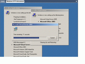

Hi all, i've got everything about working just right, and now i find the following. Midway through the install, RunOnceExGui spawns a second instance of itself, with the pending half of the installations. These two instances run at the same time, and causes half the app installs to fail because "another installation is in progress" What is causing this to happen? See the attached screenshot! Thanks Nmepar
@richvz - Brilliant! - thats the problem - if you don't explicitly define the path to the .ini in RunOnceExGui, then the installer fails silently. Having changed that, this now works. Thanks Richvz!!!!!!!! Now only one other problem, I've come across the 'cannot install from CD/ DVD' error now, copying the install files across to the hard disc and then running install works. However, it would be great if i could install from DVD. I am planning on install from DVD, will this work, or do I have to copy to hard disk, install then delete install binaries? Did you manage to get this working? from what you are saying, do I need to create the 'network install' type folder structure as per this KB and the burn that to DVD to install? THe KB does not discuss that - does it work? Any tips? Thanks for your help mate
