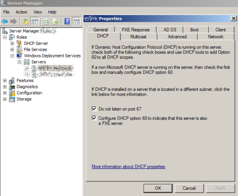

I forgot all about my earlier post in this thread. I did get VMware EFI PXE booting with WDS working. Here's an update which may help someone. VMware Support's testing made clear to me that the EFI PXE bootrom in vSphere 5.0 does definitely work, so I went back to my WDS server in more detail. The Microsoft KB (http://support.microsoft.com/kb/2012858) which comes up while researching this issue is a bit misleading. It suggested that in case of problems, an EFI PXE client should be hard-configured in WDS/DHCP to boot the boot loader boot\x64\Bootmgfw.efi In my infrastructure the WDS server is also a DHCP server. There are several workarounds for this since port 67 is used for both services. The first Microsoft-recommended method is to tick the boxes in the screenshot below: The downside of this method is that if DHCP option 60 is configured, Windows puts this in for *all* DHCP scopes on the server. With DHCP option 60, DHCP option 67 (Boot File Name) is ignored. This is not ideal because you may need to have different PXE settings for different subnets, say if you had Linux clients, or wanted to use VMware Auto-Deploy for instance. So, until now in my environment I had ticked the "Do not use port 67" option in that screenshot, but *not* the DHCP option 60. When this is the case, you need to define DHCP option 67 (Boot File Name). This had been set to boot\x86\wdsnbp.com so as to list all boot images on the WDS server as appropriate for both x86 and x64 clients. It worked fine like this for several years. When I was initially testing EFI PXE I consulted Microsoft KB2012858 and saw that I needed the loader boot\x64\bootmgfw.efi instead. But setting it to point to that file was crashing the VM. It transpires that the *only* way to get EFI PXE working with WDS when that same server is also a DHCP server is in fact to use the DHCP option 60 in that screenshot. I haven't carried out a packet trace, but I can see from the WDS logs that it's a whole lot more complex than just handing the PXE client the bootmgfw.efi loader. What it seems actually happens is that a temporary BCD boot menu is built on the WDS server (the client downloaded \Tmp\x64{25986027-7DF6-4A64-8133-BCE5DCCF5542}.bcd) and the whole thing behaves just like Windows Vista/7/2008's own proper boot loader, with Boot.sdi, and the various fonts being downloaded individually too. Perhaps there's dynamically generated stuff being sent to the client. If it isn't done exactly in the prescribed way, it fails. So really I think this ought to be made clearer in that Microsoft KB.
