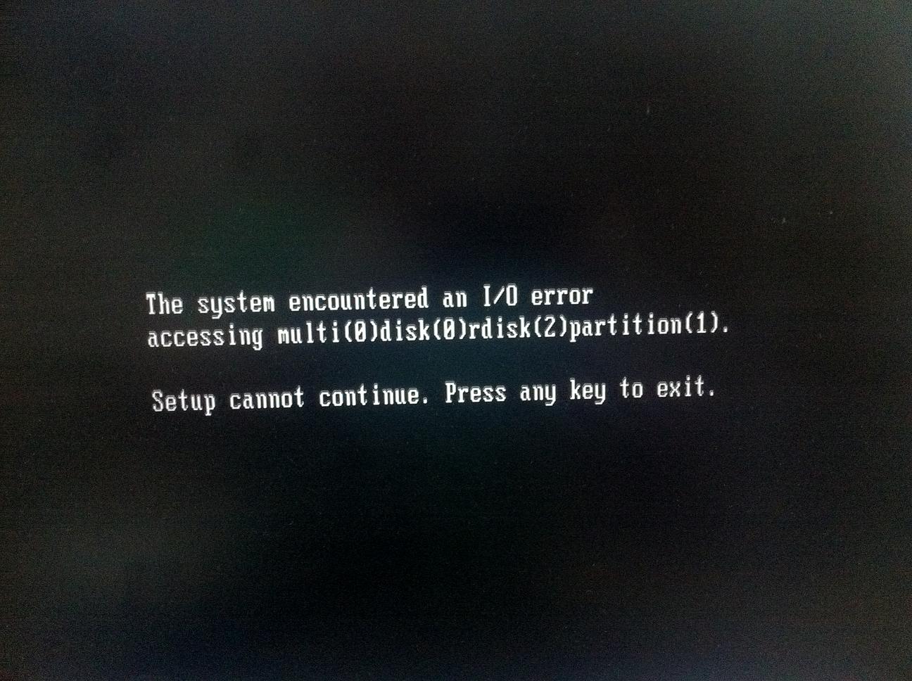

Thanks. I was thinking maybe there was a simple fix besides to reinstall or redeploy an image. The fact is that sometimes I don't realize that my stick is infected, thus broken. I go to another town to install a WinXP, and surprise! The stick doesn't work. Also, I am curious why this behaivior appears after the infection. To say things right, this is my greatest curiosity. Would you recommend a good tool (freeware maybe) for imaging USB sticks? -

Nu, I didn't use Plop at first. I've tried after with Plop, but didn't worked. -

Hello again! I've got a little question. The story so far: I've made a bootable usb disk using Beta6 (or Beta 7, doesn't matter, I think). Everything working fine, until I've plugged in the stick in an infested computer. The computer had a version of autorun.inf virus, but I desinfected the stick quite easily. The problem is that after infection/desinfection, the stick isn't working anymore. After I hit install, I get the message "Windows is now inspecting your configuration...", and right after this message, I get the error from attach. Of course, I've rebuilded the usb stick and it works again. The question is that if I have an alternate method to "fix" the usb stick, without wiping out and start from scratch. I've tried reinstalling grub4dos, but it is clearly not related to that and didn't worked. Thank you! PS: Now I asked myself where are the old pen drives with write protection...? -
