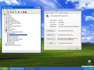

Ok, I got everything working, including CtPanel. Download EAX4DRV_AUDIGY2_1_84_50.exe through www.creative.com extract to $OEM$\$1\Drivers\005_Audigy2ZS edit winnt.sif and add: [Unattended] OemPnPDriversPath="Drivers\005_Audigy2ZS\Drivers\WDM" That will install the base drivers. edit RunOnceEx.cmd and add: IF EXIST %systemroot%\system32\drivers\ctaud2k.sys REG ADD %KEY%\010 /VE /D "Installing Audigy 2ZS CtPanel" /f IF EXIST %systemroot%\system32\drivers\ctaud2k.sys REG ADD %KEY%\010 /V 1 /D "%systemdrive%\Drivers\005_Audigy2ZS\Drivers\CTZAPXX.exe /S" /f IF EXIST %systemroot%\system32\drivers\ctaud2k.sys REG ADD %KEY%\010 /V 2 /D "xcopy.exe /y \"%systemdrive%\Drivers\005_Audigy2ZS\Drivers\WDM\COMMON\CtCtrlPan.cpl\" \"%systemroot%\system32\"" /f IF EXIST %systemroot%\system32\drivers\ctaud2k.sys REG ADD %KEY%\010 /V 3 /D "xcopy.exe /y \"%systemdrive%\Drivers\005_Audigy2ZS\Drivers\WDM\COMMON\CtPanel.exe\" \"%systemroot%\system32\"" /f The IF EXIST bits makes sure the drivers are installed, so you won't install CtPanel on systems without an Audigy sound card. We are running CTZAPXX here, because CtPanel will otherwise give an error stating that the drivers aren't installed (even though they really are). the xcopy parts copy the 2 CtPanel files to \windows\system32\. Windows automaticly checks all .cpl files in system32 and adds them to the control panel.

It does work with OemPnPDriversPath I put the entire "EAX4DRV_AUDIGY2_1_84_50" folder into "\$OEM$\$1\Drivers\030_Audio\" (just my usage, and you can probably slim it down some) then in winnt.sif, OemPnPDriversPath="Drivers\030_Audio\Drivers\WDM" (point to the WDM folder where the .inf files are) Doesn't install the CPanel of course, so you'll still need to install afterwards.
Is Step 4 needed? Does it not read the .inf file and install the base driver through using OemPnPDriversPath="Drivers\005_Audigy2ZS" ??
