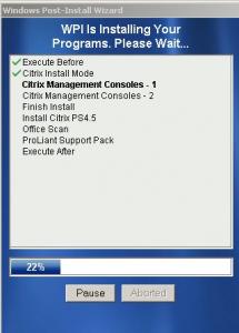

  3. I found that I got this error if I had %reboot% specified but no more packages to install after that reboot. Resolved this by using a final script (order 9999999) that ran a manual reboot and didn't specify the %reboot% variable. Perhaps that will work for you Mark
  4. Guess I needed to RTFM. Hadn't realised that 'Install By Category' was the option I wanted, manual says it all really. Still, even before this the applications weren't being installed in the order specified in my config.js but that's another story. Thanks Mark
  5. You can tell I'm a noob. Options -> Installer -> Sort Within Categories I presume. Anyway, unchecking that seems to have reverted it to the order specified in config.js which is a partial success. However it still isn't taking account of the order value. Other option I can think of is renaming each application with a prefix, something like 0001 - Proliant.... 0002 - Office Scan etc. Thanks Whoops, missed your screenshot, I'll try that in a minute
