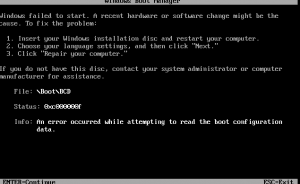

  5. I finally got vLite to work without a hitch! Turns out it was the OS. I was running some cut version of XP. Installed full version of vista and BOOM it worked :thumbup (Version 1.0 beta). Thanks nuhi, sorry to waste your time! Won't be using that version of xp again D

  7. hello, thanks to all who make this program possible. Now, I have a problem that I cannot fix. Everytime I run vlite and I get a .iso file, it will not boot! :angrym: I burn it as a boot disk! It starts to boot and I get this error \Boot\BCD I have a screen shot of the error attached. Please have a look and help. Thanks in advance for the help! Doc
