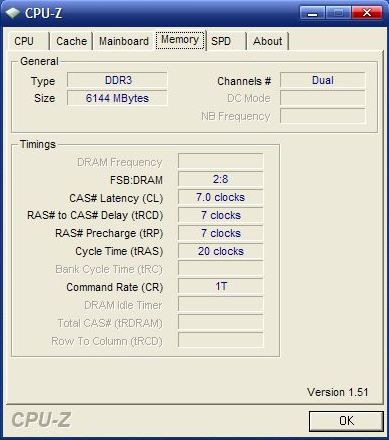

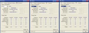

simurqq Posted June 7, 2009 Author Posted June 7, 2009 (edited) Thanks for your help, guys!However, I don't believe it's a hardware problem. My rig is only some days old and has been fully tested by a trusted person before I received it. Even more, I've attached a couple of CPU-Z screens which further prove that the computer does see the memory... As you can see from the right image, all 3 memory slots show the correct volume of memory sticks attached to them.Thank you! Edited June 7, 2009 by simurqq
gamehead200 Posted June 7, 2009 Posted June 7, 2009 Thanks for your help, guys!However, I don't believe it's a hardware problem. My rig is only some days old and has been fully tested by a trusted person before I received it. Even more, I've attached a couple of CPU-Z screens which further prove that the computer does see the memory... As you can see from the right image, all 3 memory slots show the correct volume of memory sticks attached to them.Thank you!Hmmm... I wonder if it would have something to do with the fact the RAM is setup in dual-channel mode (DDR3 is for triple-channel setups). Is there a way to setup triple-channel memory mode in the BIOS?
