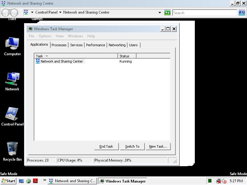

lukenuske Posted June 9, 2007 Author Posted June 9, 2007 Hey Guys,Thanks for the suggestion, I didn't even think of booting in safe mode. Unfortunately it didn't help. Vista still hangs when I go into Network and Sharing Centre and I have to end the program through Task Manager. I have attached a screendump.Maybe the forum will be hearing more about this problem?Cheers,Luke
