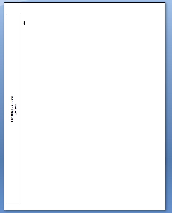

spacesurfer Posted February 16, 2007 Posted February 16, 2007 That's easy. A simpler solution is to add a text box to the side and change the text direction. Here's a screenshot:
