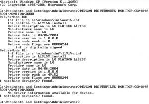

the_doc735 Posted October 3, 2006 Author Posted October 3, 2006 (edited) I have attached my monitor.inf file F.Y.I.does anyone know the procedure for updating monitor drivers in unattended/silent mode?i.e. to mimic the actions of hardware update wizard in windows xp?could I use devcon perhaps? (& run it from a batch file)...e.g.devcon /r updateni C:\LGL1915S\L1915S.INF Monitor\Default_Monitorbut devcon failed!!!I also tried: devcon install C:\LGL1915S\L1915S.INF Monitor\Default_Monitordevcon update C:\LGL1915S\L1915S.INF DISPLAY\DEFAULT_MONITOR\5&1F511D75&0&11337799&01&00devcon update C:\LGL1915S\L1915S.INF *PNP09FFdevcon update C:\LGL1915S\L1915S.INF Monitor\GSM4A90rundll32.exe setupapi,InstallHinfSection DefaultInstall 132 %systemdrive%\Install\LGL1915S\L1915S.INFAlso tried: monitor driver via OemPnPDriversPath, pyron+serialzs driver method, 1/2/3 simple driver method, sneakys driver base tool, etc.& I DO have administrator permissions.TRIED ALL SORTS OF SEARCHES AND PAID TO JOIN SOME SITES TOO! but no joy! e.g. unattended monitor driver, update monitor driver, install monitor driver, devcon failed, rundll32.exe, monitor device drivers, L1915S, LG, microsoft xp permissions etc.etc.Just thought I'd say that the L1915S source monitor driver is not corrupted as it will install via the hardware update wizard in device manager. i.e. status=device driver healthy!------------------------------------------------------------------------------rem Properties Details:REM ClassGuid={4D36E96E-E325-11CE-BFC1-08002BE10318}REM compatible IDs *PNP09FF REM device instance ID DISPLAY\DEFAULT_MONITOR\5&1F511D75&0&11337799&01&00 REM Hardware IDs Monitor\Default_Monitor rem matching device IDs. Monitor\GSM4A90 rem enumerator DISPLAYrem capabilities CM_DEVCAP_EJECTSUPPORTED, REMOVABLE, SILENTINSTALL, RAWDEVICEOK, SURPRISEREMOVALOK.rem devnode flags DN_DRIVER_LOADED, DN_STARTED, DN_DISABLEABLE, DN_REMOVABLE, DN_NT_ENUMERATOR, DN_NT_DRIVER.rem class installer Desk Cpl.MonitorClassInstaller.------------------------------------------------------------------------------Default monitor's Properties Details the same as mine except:matching device IDs. (for default monitor) Monitor\Default_Monitor.------------------------------------------------------------------------------Any ideas please??? L1915S.INF Edited October 4, 2006 by the_doc735

the_doc735 Posted October 4, 2006 Author Posted October 4, 2006 (edited) now get [output]rem Properties Details:REM compatible IDs - REM device instance ID ROOT\MONITOR\0000REM Hardware IDs Monitor\GSM4A90rem matching device IDs. - rem enumerator ROOTrem capabilities -rem devnode flags DN_ROOT_ENUMERATED, DN_HAS PROBLEM, DN_DISABLEABLE, DN_NT_ENUMERATOR, DN_NT_DRIVER.rem CONFIGFLAG_FAILED INSTALLrem class installer Desk Cpl.MonitorClassInstaller. Edited October 4, 2006 by the_doc735
the_doc735 Posted October 4, 2006 Author Posted October 4, 2006 rem devcon status monitor\gsm4a90Code 28The drivers for this device are not installed (Code 28). To reinstall the drivers for this device, click Reinstall Driver Solution button: Reinstall Driver This code means the device was not installed completely. To resolve this issue, follow the recommended solution. If that does not work, try removing the device from Device Manager and using the Add New Hardware wizard to redetect it. You may need to obtain updated drivers if the error still occurs. What is it that the hardware update wizard does to install this monitor first time, every time; but yet devcon will not?
