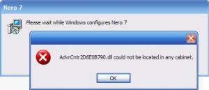

There is one slight problem though. While using this silent installer method to install, the following error occurs:
Although, if you continue with the installation it seems to continue installing with no problems.
Yeah, this is why I use the following AutoIT script to close that error message and install Nero 7.2.0.3:
to avoid error try to use command line switch - NSIROOTDIRECTORY="%TEMP%\Nero7\".
"%TEMP%\Nero7\" - folder where Nero will be unpacked.
also create folder "Cab" in install directory and put 0AA0A4EA.cab, 307C0B60.cab there.
for autoplay try switch AUTOPLAY=TRUE
