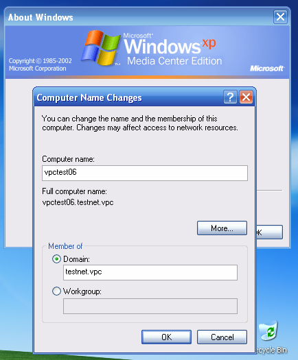

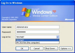

Idontwantspam Posted July 20, 2007 Posted July 20, 2007 Well, this may be a little bit late now, but just for the record: I installed XP MCE '05 in Virtual PC, and during setup, it asks if I want to join it to a domain. I said yes (I have a VM with Windows Server running AD), told it which domain, and it worked! I'll post screen shots when I get a chance. Some time I'll try the method outlined above and see how that works.
Idontwantspam Posted July 20, 2007 Posted July 20, 2007 (edited) I can verify that the procedure outlined above does indeed work. It's now possible to change the domain membership. Now if just there were a way to join XP home to a domain...EDIT:It is also possible using a BartPE CD, and that way you don't have to use the recovery console which I personally don't like, and doesn't appear to work when you rename the admin account. You must have a registry tool installed on the PE CD, then you can just go to _REMOTE_SYSTEM\\WPA\\MedCtrUpg the same as in the method above and change IsLegacyMCE to 1. It works fine! Edited September 1, 2007 by Idontwantspam
