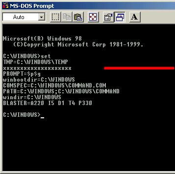

Molecule Posted February 10, 2006 Posted February 10, 2006 Has anyone seen a 20 char "unequaled" environmental variable like the one right next to the red line (I'll try to upload a png)?Where's the equals sign!If I open a ram memory editor like HxD, what address would I start at to inspect my environmental memory area, to see what's on either side of those 20"x"'s?My "autoexec.bat" is clean (just the path statement), the "config.sys" is empty, and both "mydos.sys" and "msdos.---" seem to have standard calls in them (from sp21a with md5 ok)Possibly unrelated, but I also have problems with visual c++ runtime error R6025 ("pure virtual function call") when loading a svg into mozilla with javascript on.If the png is unreadable, typing "set" at the command prompt produces this result, which shows the 20 "x"'s right after the TMP=C:\WINDOWS>setTMP=C:\WINDOWS\TEMPxxxxxxxxxxxxxxxxxxxxPROMPT=$p$gwinbootdir=C:\WINDOWSCOMSPEC=C:\WINDOWS\COMMAND.COMPATH=C:\WINDOWS;C:\WINDOWS\COMMANDwindir=C:\WINDOWSBLASTER+A220 I5 D1 T4 P330C:\WINDOWS>
LLXX Posted February 11, 2006 Posted February 11, 2006 (edited) Environment variables don't need to have equals signs in them. They're just a series of null-terminated strings, followed by another null string.what address would I start at to inspect my environmental memory area, to see what's on either side of those 20"x"'s?Here's one way...run DEBUG and then do d 0 command, this shows PSP and looks like this (addresses may vary):-d 0129E:0000 CD 20 00 A0 00 9A EE FE-1D F0 4F 03 23 0C 8A 03 . ........O.#...129E:0010 23 0C 17 03 23 0C 17 0B-01 01 01 00 02 FF FF FF #...#...........129E:0020 FF FF FF FF FF FF FF FF-FF FF FF FF*01*0C*4E 01 ..............N.129E:0030 2A 10 14 00 18 00 9E 12-FF FF FF FF 00 00 00 00 *...............129E:0040 07 0A 00 00 00 00 00 00-00 00 00 00 00 00 00 00 ................129E:0050 CD 21 CB 00 00 00 00 00-00 00 00 00 00 20 20 20 .!...........129E:0060 20 20 20 20 20 20 20 20-00 00 00 00 00 20 20 20 .....129E:0070 20 20 20 20 20 20 20 20-00 00 00 00 00 00 00 00 ........Now find the word at 2c - third line, fourth and third bytes from the end, I've highlighted that area with asterisks above (01 0C); in this case it's 0C01 - and display the start of that segment, you can use d command without address to continue displaying:-d c01:00C01:0000 54 4D 50 3D 43 3A 5C 57-49 4E 44 4F 57 53 5C 54 TMP=C:\WINDOWS\T0C01:0010 45 4D 50*00*54 45 4D 50-3D 43 3A 5C 57 49 4E 44 EMP.TEMP=C:\WIND0C01:0020 4F 57 53 5C 54 45 4D 50*00*50 52 4F 4D 50 54 3D OWS\TEMP.PROMPT=0C01:0030 24 70 24 67*00*77 69 6E-62 6F 6F 74 64 69 72 3D $p$g.winbootdir=0C01:0040 43 3A 5C 57 49 4E 44 4F-57 53*00*43 4F 4D 53 50 C:\WINDOWS.COMSP0C01:0050 45 43 3D 43 3A 5C 57 49-4E 44 4F 57 53 5C 43 4F EC=C:\WINDOWS\CO0C01:0060 4D 4D 41 4E 44 2E 43 4F-4D*00*50 41 54 48 3D 43 MMAND.COM.PATH=C0C01:0070 3A 5C 57 49 4E 44 4F 57-53 3B 43 3A 5C 57 49 4E :\WINDOWS;C:\WIN-d0C01:0080 44 4F 57 53 5C 43 4F 4D-4D 41 4E 44 3B 43 3A 5C DOWS\COMMAND;C:\0C01:0090 57 49 4E 44 4F 57 53 5C-53 59 53 54 45 4D*00*43 WINDOWS\SYSTEM.C0C01:00A0 4D 44 4C 49 4E 45 3D 77-69 6E*00*77 69 6E 64 69 MDLINE=win.windi0C01:00B0 72 3D 43 3A 5C 57 49 4E-44 4F 57 53*00 00*4C 41 r=C:\WINDOWS..LAThe highlighted zeroes indicate the end of each string in the environment block. Two zeroes in a row indicate the end of the environment block.My suspicion is that this behavior is caused by a Virus, if you have already checked to see if any environment variables are being set on startup. Edited February 11, 2006 by LLXX
barneyrubble Posted April 4, 2006 Posted April 4, 2006 Check the folder c:\windows\temp and see if it actually exists. I ran into the same problem when I set my TMP variable to point to a non-existent folder.
