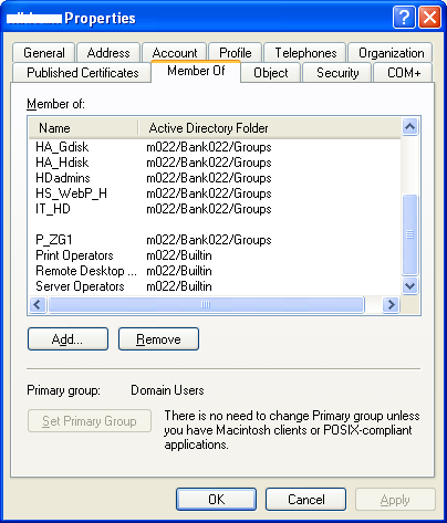

We have a Win2000 native domain with approximatelly 1000 computers. I have a strange problem with my account. I'm part of domain builtin server operators and print operators group but my PC can't resolve my real group membership..

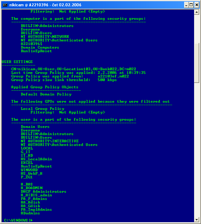

This is screenshot from my account properties:
and this is screenshot from my PC:
Local domain controller and file server is A22103EF and the group policy is applied from this server..
