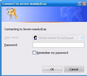

jonathan_314 Posted January 14, 2006 Posted January 14, 2006 (edited) Hey, I know that some people allready had this problem and posted here, but the proposed sollutions are not clear for me.I made a nice unattended cd for an xp pro. There is just one small problem. When I want to go on anouther pc on my network it asks the password for the guest account. The username "guest" grayed out, so I cant change it. When I run the Networkwizzard it works fine. (I added a picture of what I see)I read allready a lot of stuf about it. Like that it only occurs when you set UnattendSwitch="yes".But I wounder what makes this Network wizzard so magic? What settings does it change? And would it be possible to make those settings unattended??Thank you in advance. I hope someone can make time to post a cristal clear answer. Edited January 14, 2006 by jonathan_314
Rico.JohnnY Posted January 14, 2006 Posted January 14, 2006 (edited) First, run secpol.msc and make some necessary change for guest account. Then run secedit /export /cfg c:\GroupPolicy.inf /quiet to generate a security template. you can use that template for UA Group Policy configuring later.NOTE: you should apply the KB897327 hotfix first if you use WinXp with SP2 or you are not able to export the template normally,it can be obtained from http://www.softpedia.com/get/System/OS-Enh...3-Preview.shtml, or contact Microsoft Product Support Services for it. Don't forget to integrate it into your XPCD later if you want to successfully apply the GroupPolicy template in UA mode.Unattended process:1. Enable "file and print sharing" in Windows Xp firewall's exception list from Winnt.sif, see SP2's ref.chm for detail2. Use net user guest /active:yes to enable the guest account3. Finally runsecedit /configure /db %systemdrive%\gp.sdb /cfg X:\XX\GroupPolicy.inf /overwrite /quietgpupdatedel %systemdrive%\gp.sdbChange the path of CroupPolicy.inf accordingly.Hope this helps! Edited January 14, 2006 by Rico.JohnnY
jonathan_314 Posted January 14, 2006 Author Posted January 14, 2006 (edited) Ok, I will try that, while i was in that Local security settings page I saw something.In the "User right asigments" >> "Deny acces to this computer from the network"The Guest account was in it.On my other pc where I have run the Network wizard it doesn't has the guest in it. So If I can make a config file like you showed me how to do, then I must know all the settings that the Network wizard changed. But Ok, for now, I will try to turn the Guest account on. (on my pc with the networkwizard on, it has not the Guest account on hmm strange)I will try it anyway and let you know if it worked Edited January 14, 2006 by jonathan_314

jonathan_314 Posted January 14, 2006 Author Posted January 14, 2006 (edited) Guy, am so happy coz it worked.I mean it worked manualy. I removed the guest from the item I spoke about. And then I enabled the guest user. (I always thought that I didn't have to enable the guest user coz on the machine where it worked the guest user wasn't active, but when I looked on the same working machine the guest user was indeed enabled so there must be a difference between beeing enabled and beeing active ) Now I will try to do this unattended. So I only need to put the settings you gave me in the grouppolicy.inf file and aply them in a cmd file. and before I do that I must enable the user also in the cmd file. So I think I can put this in the runonceex.cmd file. Or not. Well I will try and if it doesnt work I will let you know. Rico.JohnnY thank you for helping me out Edited January 14, 2006 by jonathan_314
