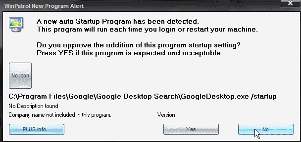

Press any key Posted November 13, 2005 Author Posted November 13, 2005 Either that, or the uninstaller didn't complete properly. You could try reinstalling GDS and then uninstalling it again.You may be onto something here. If, say GDS was left running while uninstalling. But I usually use Enditall to shut down everything first before uninstalling anything.But the programmers should have anticipated that if GDS was running it would close before the uninstall through the programming of the install/uninstall program. And all Reg keys should have been removed.As the Reg Key is persistent, it seems to indicate that they left something else on my PC that keeps replacing the Key. It's interesting that you can delete the Key with RegEdit, refresh, and it is replaced.google you suck ! It's annoying that if you do not click YES, then this will pester you every 3 seconds ..--------------------------------------------------------------------------Windows Registry Editor Version 5.00[HKEY_CURRENT_USER\Software\Microsoft\Windows\CurrentVersion\Run]"ccleaner"="\"D:\\pc tools\\CCleaner\\ccleaner.exe\" /AUTO""SpybotSD TeaTimer"="C:\\Program Files\\Spybot - Search & Destroy\\TeaTimer.exe""AWMON"="\"C:\\Program Files\\Lavasoft\\Ad-Aware SE Professional\\Ad-Watch.exe\"""Dexpot 1.3"="D:\\pc tools\\Dexpot - virtual desktops\\Dexpot.exe""Google Desktop Search"="\"C:\\Program Files\\Google\\Google Desktop Search\\GoogleDesktop.exe\" /startup"I cannot get rid of Google Desktop Search /startup. It replaces itself continually. If you do not click Yes on WinPatrol it will pop back up every 3 seconds.Not by deleting in Safe Mode, from MsConfig, WinPatrol or Spybot S&D or deleting from the Registry and turning off System Restore. It is not listed in MS AntiSpyware Start up programs at all.Downloaded Autoruns and tried that - no luck.So, Google does not have the best programmers after all - YOU SUCK. Stinkers.INSTALL google SOFTWARE AT YOUR OWN RISK!
